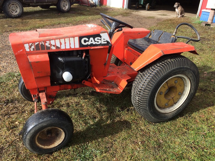

Here is a pic of the tractor - if it matters at all.

Some MORON has removed the all-important cooling tins from the heads of your ONAN. This causes overheating which often leads to pistons seizing in the cylinder/s. It also causes the oil to over-heat which can lead to other lubrication issues. Based on the posts to date, it is my opinion that this Onan is TOAST and will have to be removed from the tractor, torn down and subjected to a full rebuild. With no rear PTO control valve, there is no real reason to believe that this is a hydraulic problem.

Your original Onan doesn't have the original or any other cooling shrouds, it's pistons are probably melted.

Ya I would agree the engine is likely toast due to running without the tins. Someone f'd up there, maybe took them off to clean out a mouse nest or debris.
Nice tractors tho so its worth rebuilding the engine... and the hy-drive is a pretty nice system imo.
I just had a 448 in here for repair, owner said the starter would just click.... ya I guess so when both pistons are stuck, he left it parked outside for a few years. I got it freed up and it will start but I suggested he get the Onan rebuilt.
