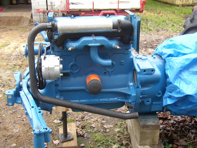

I do not know what your saying is the cast turn up. What I did on my '63 4000 diesel SOS, was use the bracket you show, without the short piece of pipe you show it has, and used the exhaust pipe, Part No: 311051, from YT.
I took the bracket, and cut part of the loop off it, and welded a
flat piece, that I curved, for a place for a clamp to hold it all tight to the engine, so that nothing wobbled loose.
I'll post a picture of it later today, after I get home around noon.
It does end just past the transmission & motor split. Where there is a bracket to support the pipe, is suppose to be. I'm just going to make my bracket for it there, and at the tail end of the tail pipe.
I am not going to leave the tail pipe off mine. I would think the fumes would come up to easy to me. I am going to just buy a straight piece of pipe from the muffler shop, and cut it off where I want it to end. Straight pipe is cheap to buy from a muffler shop, not at a parts store. I paid a dollar a foot for it, last year. They should flare the end for free. They did when I bought a 10 foot piece for my car.
I do not remember if the end is flared. I'll have to look at mine to see.

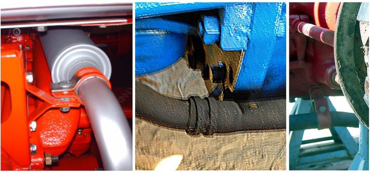

John, I switched my 4000 row gasser over to low exhaust last year. I used Stanley components that I ordered through Rural King, but if I was to do it again I'd use OEM New Holland parts. The Stanley parts don't fit well: I had to re-use my original cast iron elbow as the bolt holes were mis-drilled in the new one.
I don't know exactly what the OEM brackets look like, but I re-used my vertical exhaust bracket as you suggest. I just cut out the old pipe and ran the new one through the hole. I didn't bother trying to weld anything to it; the pipe just sits loose in the hole.
I can't say what the OEM lower brackets look like; I just used universal hangers from the auto parts store.
The replacement pipe on my row crop ends right at the engine/transmission split. It ends straight and the tailpipe is flared. My tailpipe was way too long so I had to cut off the flare (either that or the downturn at the other end), and used a coupling to mate the two pipes.

Dollar Bill
Long Time User
Joined: 01 May 2008
Posts: 1118
Location: Keystone Heights, FL
Report to Moderator
PostPosted: Tue Nov 20, 2018 3:22 am    Post subject: Re: Muffler and exhaust Reply to specific post Reply with quote
CVPost-John in La wrote:
1) Does any one have some pictures of under the tractor so I can see how the brackets work?
I hope these pix will help with your smoke stack conversion.
Back to top

TinCan
Regular
Joined: 14 Sep 2017
Posts: 356
Location: Deer Lodge, TN
Report to Moderator
PostPosted: Tue Nov 20, 2018 4:19 pm    Post subject: Re: Muffler and exhaust Reply to specific post Reply with quote
Ok, I got a picture of my exhaust. You can't really see the bracket at the front of the muffler. I'll be out there working on it again tomorrow, and I'll take a close up of it then. I do not have the tail pipe on it yet.
Pat
