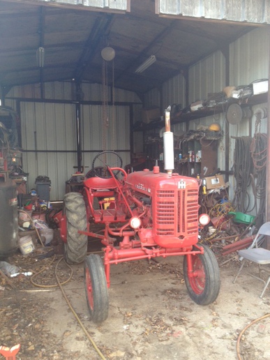

PostPosted: Fri Jan 04, 2019 8:02 am    Post subject: Re: best option for heat in painting area Reply to specific post Reply with quote
Here is my shop.....I think it is a 12x24.
Back to top
View user's profile
showcrop
Tractor Guru
Joined: 13 Dec 2000
Posts: 22250
Location: Chester NH
Report to Moderator
PostPosted: Fri Jan 04, 2019 8:37 am    Post subject: Re: best option for heat in painting area Reply to specific post Reply with quote
RTR wrote:
(quoted from post at 09:02:54 01/04/19) Here is my shop.....I think it is a 12x24.
Well, it is of course all relative. As small as it is it could not take a whole lot, and of course it depends on the cost of the gas. I use propane here at $2.60/ gal. so it would be a lot. If I were you I would get specs on a particular unit in order to see how much it is rated to use per hour.
