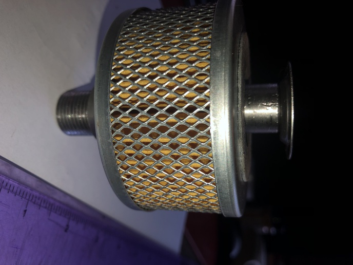

I pulled the stud from the pump. Hard parts individually less the spring and assembled with with the 1.6" high filter. Filter is about 1/2" short or shaft is 1/2" long
Does this help make clear the issue? any ideas?

Looks like the wrong filter from what I used to put in at the MF dealer I worked for.

I just came back from a tractor shop. Not a dealer, but they have access to the same parts. He says, based on the part number its the right filter and to find a taller one without a part number isn't realistic.
So I can move forward, I bought a washer that is close to the shaft size. I am going to use that first, then an o-ring, then the filter, then the machined part with the spring on top and not use the cup.

1023057M1 is the taller filter.

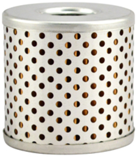

PostPosted: Thu Dec 06, 2018 10:25 pm    Post subject: Re: Power steering pump pictures Reply to specific post Reply with quote
AGCO 1023057M1
New Holland 167495
Baldwin PT459
O.D.: 2 3/32"
I.D.: 23/32"
Length: 2 1/16"

PT that certainly makes more sense. Given mine is a MHF and the serial number is before the year was tracked, it is logical that the pump would be an early one. The early one is suppose to be a taller reservoir. To my eyes my reservoir seemed wider than tall. I should have taken and posted its dimensions, which I will. Someone must of tried to use the cap from a later model which is what I zeroed in on.

Shaeff that makes more sense. To my eyes the reservoir was wider and when I called and talked with Yesterday, they said there is no taller filter. So it fed my confusion.

There are two types of pumps, the Barnes pump and the Cessna pump. It looks like you have a Barnes shorter, wider filter in a Cessna pump
The Cessna pump has a taller, narrower reservoir.
The Barnes pump has a shorter, wider reservoir
Does your reservoir anything like Fill Line embossed on the reservoir?.

Not that I can see. I will take the measurements of the reservoir and take some pictures and share that info. To me it looks like it is wider than it is tall. and the machined metal part is not in the Cessna parts schematic. I am guessing over the years its a combination of pump parts. For now I am comfortable with my work-a-round. Fluid will go through the filter and I can see the port in the bottom of the reservoir.
