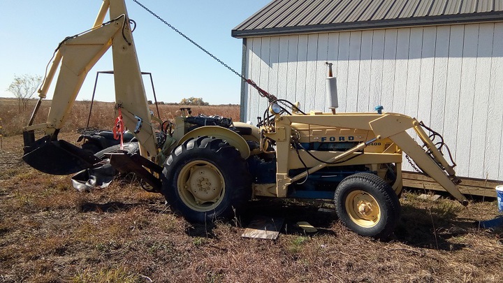

Hey all,
I am so close to having my 3400 backhoe/FEL going. This was a project that I bought not running so I've never seen the backhoe or FEL working. I got the filter changed and put new fluid in. I started the tractor and the main pressure line popped and spilled fluid everywhere. I put it back together and tightened the hose clamp and it blew the other end of the hose off, same situation. Long story short, it seems that it is building pressure but isn't able to flow freely. How would I see about figuring out the problem? I don't know if its the valve for the backhoe or if maybe the return line is clogged or a bypass or some sort? I assume the oil is continually flowing whether the valves are being used or not since its a crank driven pump. This is a 713 backhoe, and the plumbing goes from the pump, through the backhoe, then to the front end loader.
Thanks for any help! Hydraulics are foreign to me at this point, I don't have much experience with diagnosing them.

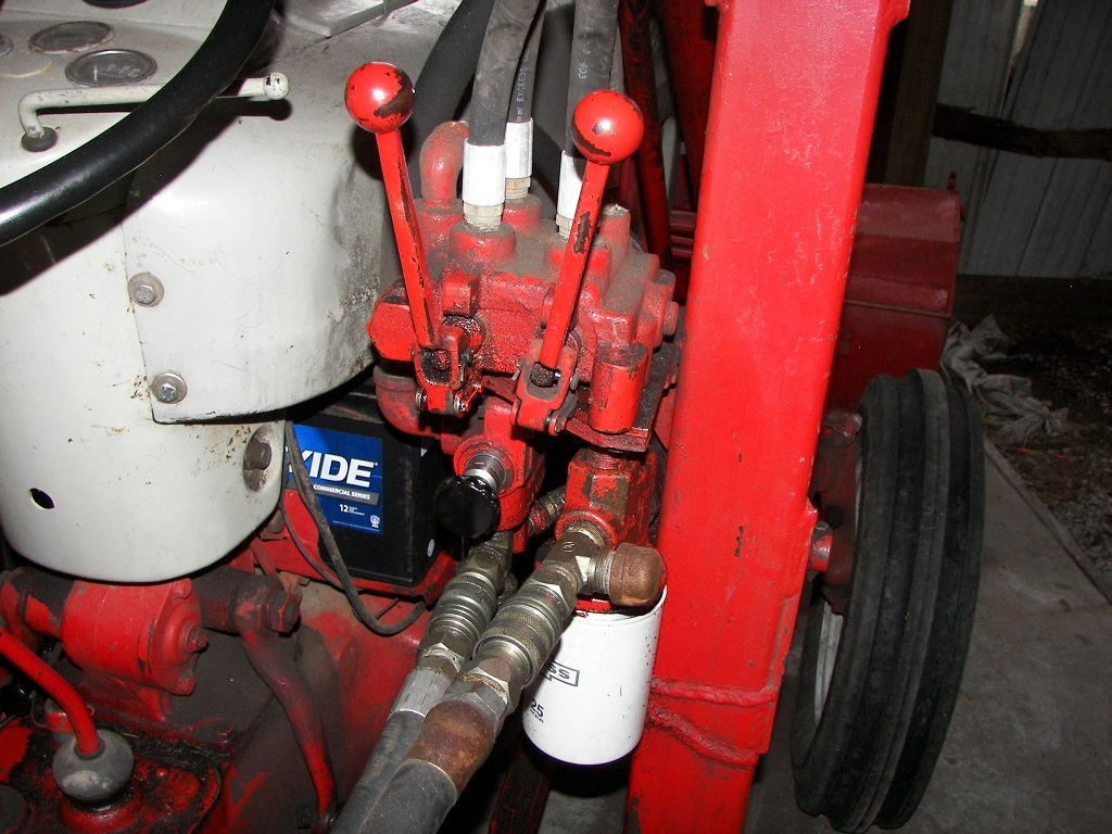

the setup would be similar to the first diagram. The third picture
is the selector valve on my tractor (19-97 loader and 713 backhoe).

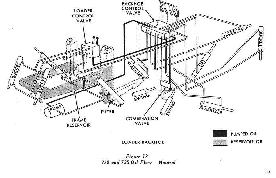

Some additional information. I'm going to guess that you have a 730 loader, the most common for a 3400. Well, when the 730 was paired with a 750 backhoe the flow was different than in the 713 era. The pump output went to the backhoe valve first then, via power beyond on the backhoe valve, on to the loader. See diagram below. I think you have some engineering and plumbing to do.

Thank you so much Andy! Can I ask what book those diagrams came out of? I bought a set of books for mine but misplaced them during my move. Those diagrams will at least allow me to see if it's plumbed correctly. Since it was a giant puzzle, I wouldn't make any bets
Mine does have a selector valve very similar to yours so it must not have power beyond. I know it is a 713 backhoe but I haven't been able to find a tag on the loader to be able to identify it. I've included a picture from one of my last posts if it means anything to you. Just looking at pictures online, it doesn't have the same bracing on top as a 19-97 or 19-105.

The diagrams came from the Series 713 Ford Backhoes Service Manual.
I believe your loader is a 730. They did make a diverter valve kit
for the 730, see web page below, but I'm not sure what it was
intended for (as I said in a previous post with the 730/750 loader
backhoe combination of that period pump output went to the backhoe
valve first).

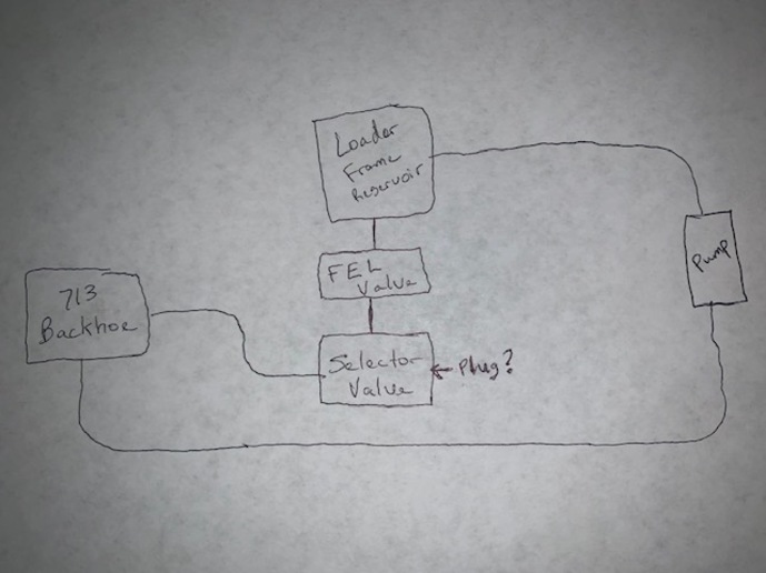

PostPosted: Wed Jan 02, 2019 5:39 pm    Post subject: Re: 713 backhoe pressure line blowing Reply to specific post Reply with quote
Okay I’m back, unfortunately... I had a hose made to replace the hose clamp/splice that the tractor came with. I got it installed, fired up the tractor and was able to run it without anything blowing, sort of. There were no leaks or anything but when I tried the FEL levers, nothing happened. Before I tried the backhoe levers, I decided to switch the output of the selector valve to see if that was the issue. That’s when things went south... the pressure built up and ended up blowing a hole in one of the old hoses, the one from the backhoe to the selector valve. Thats when I decided to really study the system and see if I can figure out what the issue is.
I noticed there is a plug on the selector valve. I am assuming when I pulled that valves lever, I switched it to the “plugged” outlet and the pressure had nowhere to go, other than the weakest hose. I don’t understand the point of the selector valve the way it is currently plumbed. I’ve attached a simple drawing of the way it is plumbed. I would appreciate any words to help me understand what I need to do to fix it. I obviously had pressure up to the selector valve, assuming it was going through that and into the FEL valve, why would the FEL not work? Air in the lines? I’ll be honest, I’m pretty mechanically inclined but hydraulics have never been my strong suit.
