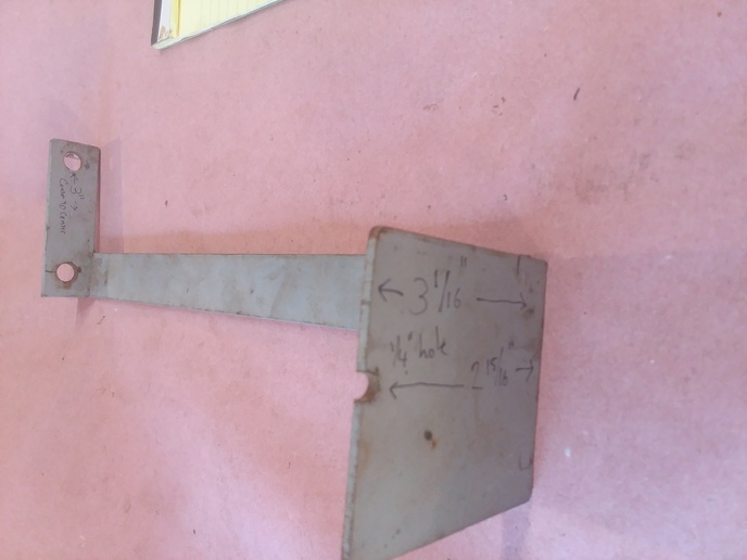

Is there a place to buy his setup jig for my 8N? I just found out that he has passed this past August.

Tom, how big a hurry are you? If you could give me
a couple of weeks I could duplicate the one I have
and send it to you. The jig works well but Zane?s
copy machine must have been about to go belly up
because the instructions are difficult to read. I?ll do
the best I can copying those for you. Dan.

The so-called Zane Thang is a device to simulate position control for use on 9/2N tractors.
The OP is asking about the adjustment jig, an entirely different device.

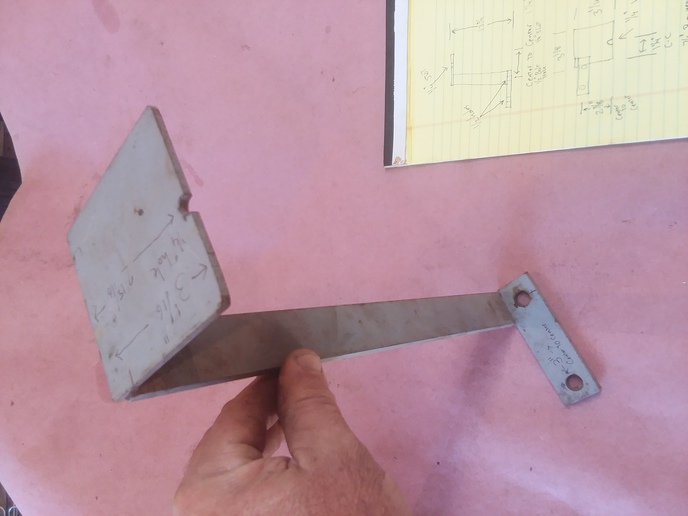

Tom Massachusetts wrote:
(quoted from post at 11:10:35 12/09/1Cool Hey Big Dan, Bill has sent me a set of the directions that are easy to read, so I just need the Jig. Thanks, Tom
I saw years ago a post with a picture that showed how to adjust your linkage using a common framing square . It was laid flat on the housing ( which is upside down ) and inline with the edge of a bolt hole , then you measured "X" distance to the rod . Really very simple . The jig makes it easier but it really is an easy task . Might have been the FO4 manual ???
Hopefully someone has saved it and will re post the link .
I have a jig and think I can put my hands on it this afternoon . If so I will take measurements and post a pic . I would not do that if Zane or his family were still marketing the jig Wink
