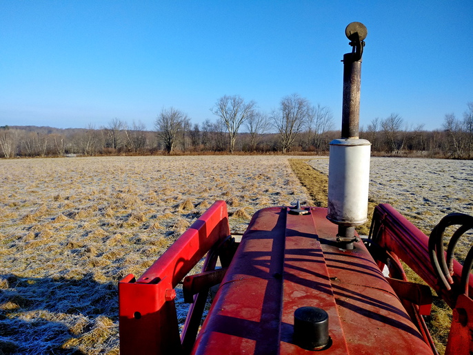

It was cold enough for long enough that the ground allowed the tractor to be driven over the field without sinking in.
Weather was nice, and I was keen.
Took the mulcher out and did one of the paddocks (~9 acres).

In Northern Iowa if your mulching/mowing it this late would just screw up next years hay. We are cold enough it will not rot by spring. So when you would go back to mow it with a sickle bar mower the dead stuff that, you mowed, off and clumped up with the bushog, will plug the guards the next spring. Then if you rake very low to the ground you will pickup the dead grass and mix it in the "new" hay. IF your feeding it you will have much more waste as most cows will not eat the dead grass. They will pull out good and dead mix, by doing this they will drop more of the good hay. If your selling the hay you will have more tons/bales but they will be lower quality/lower price.
If your going to mow the old stand off the earlier the better. Hopefully it will rot enough to not cause you issues.

In the end I was simply annoyed every time I walked the field and looked at it, and got so fed up, I had to do "something"! Smile
We will likely NOT be able to get any hay cut until late, late June or early July around these parts. So I am hoping the mulched stuff will truly have rotted away by then.

Chopped residue will always rot faster than "Cycle-Bar" cuttings will..
Maybe you can rake it and burn it in the spring..?
