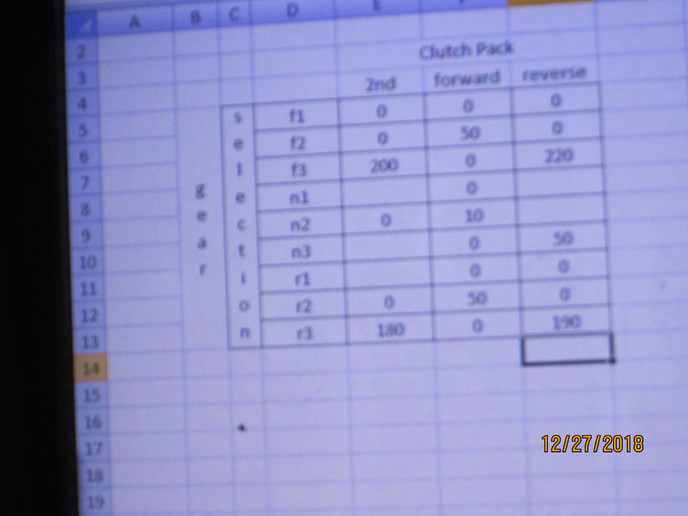

New Poster Here.
I am Elanier81's brother and have been working with him on the H60 payloader.
Following are some clutch pack pressures. Although these are in a chart, they were taking with only one pressure gage, so all readings are actually one at a time. Also, I did not get all gear selection pressures on each clutch pack.
2nd clutch pack n2-0, r2-0,r3-180,f3-200,f1-0,f2-0
reverse clutch pack f3-220,n3-50,r3-190,r2-0,r1-0,f1-0,f2-0,
fwd clutch pack f1-0,f2-50,f3-0,r1-0,r2-50,r3-0,n1-0,n2-10,n3-0
Note that while reading the reverse clutch pack pressure, it reads high pressure when both reverse 3 (which it should) and forward 3 are selected. It seems to me the reverse clutch pack should read 0 when forward is selected.

I know the clutch pressure display is a mess. I tried to paste an excel chart and I couldn't properly. I then tried to set it up as a chart in the box, but when I previewed it, it was ran together.

Take a photo of your chart and post that.

PostPosted: Thu Dec 27, 2018 9:42 am    Post subject: Re: H60E transmission problems Reply to specific post Reply with quote
here is the photo[img][/img]

PostPosted: Thu Dec 27, 2018 9:48 am    Post subject: Re: H60E transmission problems Reply to specific post Reply with quote
2nd try on the photo

First, the picture of the pressures I posted earlier is incorrect. The labels in the manual which shows the location of the pressure taps are incorrect.
We recorded some new pressures last week. We only had one pressure gage again. All of the pressures under "forward" were recorded and then the gage was moved to the "reverse" pressure tap and the pressures recorded.
Gear-----------Forward clutch pack----------reverse clutch pack
N1------------------------0----------------------------0
F1------------------------100-------------------------0
r1-------------------------0---------------------------100
n2------------------------0---------------------------0
f2------------------------140-------------------------0
r2------------------------0----------------------------110
n3------------------------0---------------------------0
f3------------------------240--------------------------0
r3------------------------0---------------------------225
These readings make more sense. We have purchased a total of 10 gages for our next trip (end of march) so we can record all of the pressure readings at the same time.
