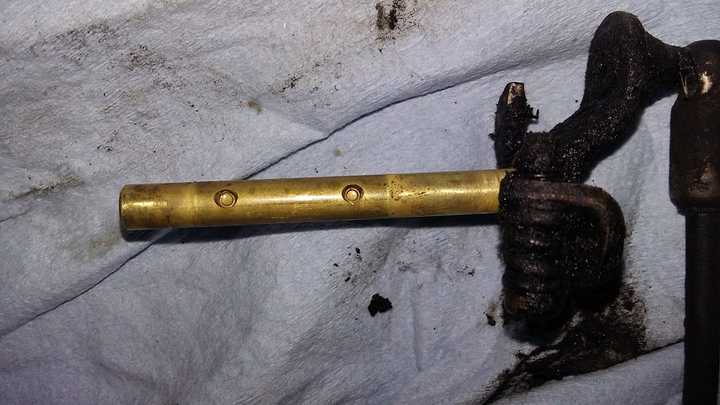

I have a 1952 8N. I was running it the other day with no problems (light work, pulling a trailer with brush), but when I pulled it in to park it, and tried to reduce the
throttle, it did not respond. So I increased the throttle again, and then it revved up to what sounded like maximum-plus rpms. I was startled and immediately turned off
the key. I re-started it right away, and it immediately revved up to max again, and would not respond to the throttle, so I shut it off again. I checked the linkages from
the throttle to the governor to the carb, and all are connected and all move. I?ve never paid much attention to how the arms on the governor actually move, but they
appear to be moving as they should. I tapped the carb and the governor with a hammer in case anything was lightly stuck (hey, you never know, right?), but it still
revved up to max immediately upon starting. So, is this a governor problem I have here? And if so, am I looking at a rebuild, a replace, or what? Appreciate any help!

The throttle butterfly (in the throat of the carburetor) is held to the throttle shaft by two little screws, it wouldn't be the first time they've fallen out.
If that's not the problem, the way a "N" governor works is that the external spring tries to pull the throttle wide open, and centrifugal force acting on the weights (balls) inside the governor tries to pull the throttle closed, and the speed at which the forces balance is the speed the engine will run at a given throttle setting.
The force from the weights passes through a ball thrust bearing onward to the "fork" on the governor output shaft, making the lever on the outside of the governor move to close the throttle butterfly.
If the bearing fails and comes apart, that makes for a lot of "lost motion" so the governor can't fully close the throttle butterfly to control speed.
So that's what I'd check for... first, check if the throttle butterfly has come loose, then remove the governor and check the mechanism between the weights (balls) and the governor output arm.

Sooo....I took the links off as suggested and could not control the RPMs by hand. So I took the carb off and...SURPISE!....no butterfly disc at all...it’s gone. So obviously that was the problem. I assume it got sucked into the engine, because it’s nowhere to be found. So I’ll have to get a new one. BUT, there’s no way to screw the new one onto the old pivot-arm...the little screws can’t be turned. So I’m assuming a carb rebuild kit will have all that? (Not the disc itself but the pivot-arm and the little screws)[/quote]

Here’s the pivot-arm I’m talking about...I don’t know what it’s actually called:

GerberHillTim wrote:
(quoted from post at 17:36:27 12/31/1Cool
[/quote]
WOW, I made a good guess, eh?
Looks like you should be able to grab the remains of the screws with a small Vise Grip and unscrew them.
A "basic" carb kit likely won't have a "throttle shaft" in it but a "complete" or "master" kit probably will, as the ones sold by this very site do.
Wonder where the butterfly went... it's brass and the "side valve" engine has lots of clearance between the piston and head.
One bad scenario would be if it wedged under a valve so it couldn't close/seal.

So in looking on here, I don’t see where they sell JUST the butterfly disc for the 8N (I see they do for the NAA and up). The only one that has the disc is the $54 total rebuild kit, and I don’t want to do a total rebuild. I could by the throttle arm and the gaskets and the disc all separately for probably a third of that if they sell the disc by itself. Am I missing that somewhere?

Now, in looking a bit closer, it appears that the disc they describe as only going on NAA and newer actually has the same part number as the 8N (9N9585).....so maybe I’m ok just getting that and the other parts separately. With the cost of shipping on here, I hate to have to order some different part later because I made a mistake.

I'd pull the manifold off and see if you are luck and find it in the manifold or in one of the intake holes. That way down the road you will not be having it get stuck In a valve or worst get into the engine it self Not sure where your at but I bet there are a number of people on here that would have that part laying around. I'd almost bet I have one out in my shop
