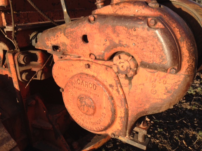

My neighbor has a HD-10B 3865 Crawler Tractor. He has a service manual for an HD-11 Crawler tractor (prior to serial #6427). The hand clutch described in service manual says it should be adjusted to 25-30 pounds using a spring scale. We have adjusted adjuster ring to increase tension and the most we can get is 15 pounds on scale. According to service manual it says do not continue to use crawler if hand clutch cannot be tensioned equal to or higher than 15 lbs. Neighbor was told clutch was serviced by past seller yet I expect clutch is worn out, or clutch springs worn out. Clutch starts to slip when going up hills are trying to push out small stump in low gears. I wonder how similar the clutch specs are between a HD-10B and HD-11? On bell housing of HD-10B is a tag with a date 6. 60. Machine was also painted orange over yellow in years gone by. Neighbor was told HD-10B was used as a pulling crawler and then front blade and hydraulics were added years later. You can see how the hydraulic cylinders were welded onto machine. I am going to start disassembling clutch this coming week possibly to see condition of clutch disc and related parts. Any specs for a 10B would be greatly appreciated. Thank you

The hand cluch should be 25-30 pound and you could check the links actuating and lever actuating are't to worn with pines it
could change the adjusting.

So the clutch spring pressure is same for the 10B your saying?

I am't sure the HD11 have 1 dry master cluch and 2 models oil master cluch

Just found out today crawler is a 1954 HD9B with 471 Detroit diesel engine. Anyone have the spring pressure spec for the engine hand clutch?
