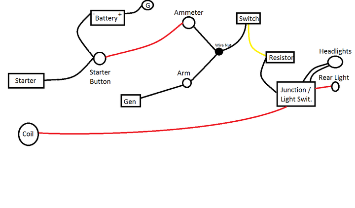

So a couple months ago the tractor started running terrible.. Missing and sputtering then wouldn't restart after it died. No fire to the plug, but it would turn over fine.
Today I got around to looking at it and with key on, I have power to the coil. I replaced the coil, but now I'm not getting power to the starter. The switch seems to bench test fins as it is open normally, and closes when button is pushed, yet I get no power to the starter with it mounted.

Alright... I "think" this project was wired correctly... I cleaned all the connections and drew a quick little schematic.
The S/N is 9N139524
