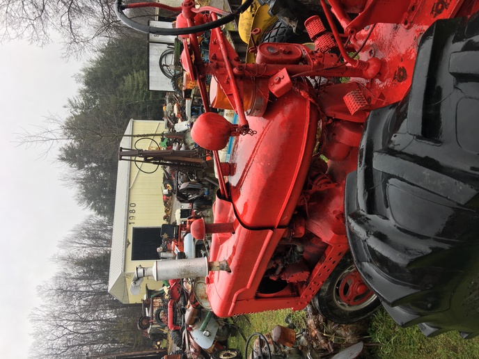

Thabks! This is the only picture I have of that area of the one tractor. Unfortunately someone painted off the serial number tag. Any idea based off this picture if it’s an H or Super H? I know it’s a lot to ask.

Ok, that "battery under the seat" is not the same as the Super H battery box under the seat.
In your picture I can clearly see a deck-mounted seat frame. The battery appears to be BESIDE the seat, on the right side, as I can see battery cables running to that area.
That is a farmer modification, nothing IH ever did.
On a Super H, the battery box is directly under the seat, as the base of the seat frame.
I am 99.9% positive that it is an H, just by the location of the starter switch. Super H's had the starter switch mounted directly on the starter itself.

Thanks! It was advertised as an H but just wanted to be sure. Is it easy to move the battery back to the original spot? I guess it doesn’t really matter either way but just wondering.

Correct. An H never had a battery box NEXT to the seat, but the original Farmall MD did have that box next to the seat, on the right side. Also had a battery box under the tank, just like any M.

It's pretty easy to return it to the stock location. All you need is a whole new battery box and the bolts.
