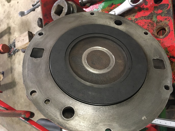

I am rebuilding an 1855.
I done the reared and transmission and am now in the process of putting the brakes together.
You can see in the pics that the brake piston had been riding against the bull pinion(with brake applied) but even with new brake discs there is only 1/16 clearance left between a fully retracted brake piston and the pinion with all brake parts in place
What am I missing here?

Was there supposed to be thin shims in there between the cover and housing or was that just some of the late ones with a mechanical actuator?

Are you sure the discs are the right thickness? If too thin that will cause the trouble you have.

Have you backed out the adjusting screw for the parking brake actuator?

Did someone machine the outer or separator plates too thin? That is about all it could be. I see the piece of fiber glued to the piston, so that isn't it. I would compare parts with the other side.

Both sides are identical in measurements.
Regardless of the internal brake parts is the fact that the brake pistons have a maximal travel of only 3/16' from all the way retracted till it bottoms out against the bull pinion. 1/16th of that travel is the necessary brake disc release clearance, which leaves only 1/8" to wear away on the discs before the piston hits the pinion,...which is not very much IMO.
Thicker brake discs would not fit as there is no room for it
New discs are just a wee bit over 1/2' thick.

Yes shim packs behind the brake/pinion housing will affect pinion to brake piston distance but that cannot be altered as the shim packs control differential/bull pinion end play.

Have you removed the piston from the housing? I had one that the stem for the parking brake part of the piston broke, although everything was still in tacked and not leaking, it created a situation like what you have by increasing the overall length/height of the piston

# 34 is an fiber insulator that goes between the brake disc and the adjuster plate.
The 0 rings in the piston housings have been replaced and everything looks fine in there.
Bull pinion face to end of housing distance are within a couple thou of each other.
Differential carrier and crown/pinion backlash have been reset to factory specs which required removal of 1 shim each side.
AFAIAC the only way to increase piston travel is to machine the face of the piston back a bit where it contacts the bull gear but there ain't enough meat Imo to do that safely without risking piston integrity.
I'm at a loss.

Yep, both piston were hitting the pinions but new brake discs solved the problem for now.
The as you call it.. the friction discs.. are in my case not bonded to the pistons. as for the part # I relied on the # Tractorderic posted but it could be #10,..I did not verify.
All the part #'s on the pinion,brake housing, brake parts and cover are the same as listed in the 1855 parts book I have.
