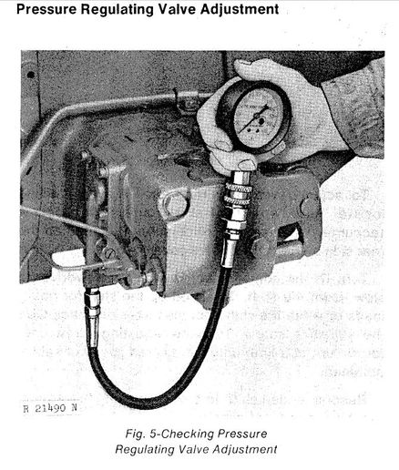

I have a john deere 302-A backhoe. Everything works as it should expect it will not go forward. The reverse works fine. I have replaced the main clutch and replaced the forward clutch pack the old one was burnt up. The hoe is full of oil but still no forward movement I have a manual and parts book for the machine. But it's hard to tell where to check the pressure on the reverser. If anyone can help I would sure appreciate it. I was wondering if you welded up the front clutch pack would it move then and just use it like a regular manual trans just have the reverser for reverse only.

My manual is a john deere TM-1090 but it's
a reprint. It shows to check the pressure
on the right side of the tractor by the
reverser valve but the pic isn't real
clear.

This is just a shot at maybe being a help to you. Here are the photos from the reverser diagnostic section of my 2030 manual, see if they are similar and clearer. HTH

That looks like the same from what I can
tell.

Were my photos clear enough to help you find the locations to attach gauges for testing? Did you see a reply on the John Deere Forum, from TxJim, about checking for a missing roll pin?

I just wish I knew exactly where to check
the pressure for the reverser. My manual
just says at the bottom of the reverser
valve

I believe the last photo, fig. 5, is that check, the check of the system pressure regulating valve. Fig. 7 is checking the individual clutch pressures. The gauge is shown hooked into the tap for the forward clutch. The reverse clutch tap should be just behind it, towards the rear of the tractor.

Yeah mine has 2 plugs on top of the
reverser valve. I'm waiting on my guages
to come in so I can check the pressure.
