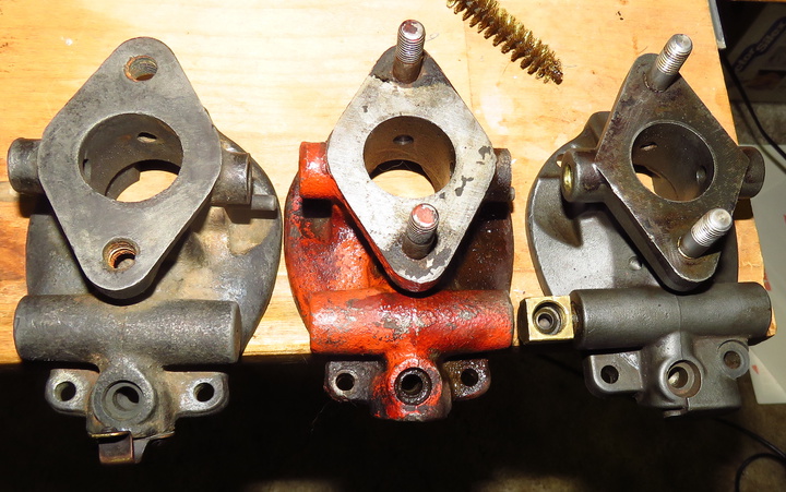

Well, guess I did learn someting today!! any idea why?
can you tell from this photo which one is M/S carb? All three are cast iron.
Not sure what you're referring to as to "any idea why".
Hard to tell on those carbs tops from just one picture, but the one
on the right appears to be an aftermarket 8N-9510, possibly a C.
It has the one raised bolt section on the bottom right in the pic.
The one on the left has the brass keeper for the main adjuster.
That was a feature on SOME original M/S carbs but not all.
I have not seen it on the aftermarkets, so I would go with that one.

The "any idea why" question was referring to tightening the screws.
The red one is the only M/S carb, it is a tsx33, the other two are not marked. thanks for the info about the raised bolt hole on the one on the right.
Just cleaning them up to build a good one, will use the tsx 33 one. I will he carb cleaner was as good as it was back in the 60's.

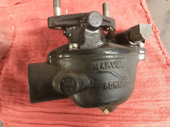

Unfortunately, carb cleaner is not as good as it used to be.
Not all M/S carb tops were marked on the outside of the lip.
Some had a very thin top lip that wasn't wide enough to cast
the name in like the others had. Like the one on this TSX-33.

OK, one of the unmarked ones does have the thin lip like in your photo, It has a problem with the threads in one of the stud holes, so may not use that one.
Thanks for the information.

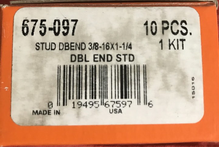

"It has a problem with the threads in one of the stud holes"
You have options, so you don't need to use that one.
If you ever do decide to fix it though, I drill them out and tap
them to 3/8 vs the original 5/16, then use a 3/8NC-5/16NF stud.
That leaves the original size to fit the manifold. Works great.

Did not think about that but I was thinking about a helicoil insert. with the thru threads your solution might just be the best ida. Thanks. Will tuck that bit of knowledge away for future use. Think I will put a tag on it with that solution written on it, heck someone else may benefit from it if not myself.
