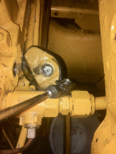

Well I removed the line going to that port in question, I see nothing in it. I will try to attach a picture. it is a mirror looking into that port, as you can see, I see nothing in it. It is 2 1/4" to the back, if that 5/16 rod is 31/2" long, I can't see how it would fit.I tried to move it, does not move. looks like it has a dimple in it. I can not see what that 5/16" rod would do?
If it helps any, here is the Tractor and Engine Serial #
Tractor MD.# Jet Star, SN 16500769, Engine MD.# 06L-4,

JK2
Long Time User
Joined: 19 Aug 2004
Posts: 599
Report to Moderator
PostPosted: Fri Jan 18, 2019 6:45 pm    Post subject: Re: Minneapolis Moline Jet Star, Hyd fluid getting into Diff Reply to specific post Reply with quote
The reason you can't find the items by the number I stated is my fault because I was in the 445 book not the jetstar book. Sorry

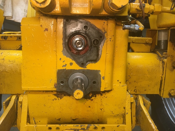

Since I have to have it, I made it, see pic. This should work?
The only question is, how far do I turn it in? I did a temporary install, turned it in, so it does move. I hope that is a good thing?
it was at 2 1/4" in now it is 2 1/2" in from the outside edge. just need to know where to park it? Do I adjust it after I get it operating?
I tried looking into the opening but had no luck see anything.With a lite in the hole I can see it from that opening but that was all.
The other question I have is about the drive shaft sleeve gasket, brass ring, item 28 in the attached pic. It shows one on each end of the sleeve. the parts manual, under quantity list one. Would like to know if I need one on each end. as you can see in the previous pic I posted, there is one in the tractor, do I put another one in the pump, as the picture shoes. I do not have one there now.
After finding the bad o ring on the pump supply hole, I think I will get some new gaskets and o ring and put this back together. Now that I know where to check for leaks, I will test this. I just need to know how far to turn that adjusting rod I made.
Thanks again for all your help and the help of everybody.

PostPosted: Sun Jan 20, 2019 5:45 pm    Post subject: Re: Minneapolis Moline Jet Star, Hyd fluid getting into Diff Reply to specific post Reply with quote
I have always just snugged them up against then locked with the lock nut.
As for the brass/copper ring I have just put back what was there or measured and calculated to hold the tapered roller bearings snugly in the hole without moving back & forth.
John

PostPosted: Mon Jan 21, 2019 8:50 am    Post subject: Re: Minneapolis Moline Jet Star, Hyd fluid getting into Diff Reply to specific post Reply with quote
Wasn't near a computer most of last week. JK2 giving you good advice. when you looked in that hole with a mirror, you was looking at the back side of item 28 on Page 89 of Parts book R-2013A. If you are lucky and the O Ring isn't damaged and 28 isn't bent, just screw your new screw in against 28 until it bottoms out. No extra force, and lock in place.
The copper ring gaskets seal the sleeve for diff. fluid and any hyd fluid leaking from pump seal from leaking out between the gasket between pump and diff. case.

PostPosted: Mon Jan 21, 2019 10:55 am    Post subject: Re: Minneapolis Moline Jet Star, Hyd fluid getting into Diff Reply to specific post Reply with quote
MMDEL wrote:
(quoted from post at 09:50:05 01/21/19) Wasn't near a computer most of last week. JK2 giving you good advice. when you looked in that hole with a mirror, you was looking at the back side of item 28 on Page 89 of Parts book R-2013A. If you are lucky and the O Ring isn't damaged and 28 isn't bent, just screw your new screw in against 28 until it bottoms out. No extra force, and lock in place.
MMDEL
MMDEL,
page 89 is for "B" type hyd. system, but I think the part you are talking about is item 31 on page 89A, type "C" hyd sys.
I now think I understand what you are saying about it poping out the o ring. I did not realize that rod was pushing against tube and fitting. Like I mentioned before, when I first took a measure from the edge of hole to where it stops, it was 2 1/4" after I put that fitting I made into it and screwing it in, I did not bottom it out, but did take up a couple turns. I removed the rod and took another measurement, it was now 2 1/2". so I guess I would want to snug up that bolt to push that tube completely in tight, correct?
I just sent an e mail to Dale about getting some of the parts I need.
