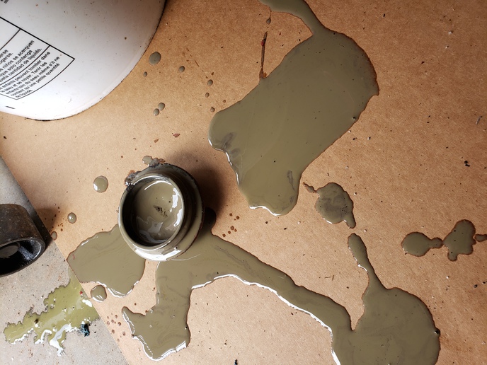

A friend purchased this 1950 Ford 8N tractor. We went to do general maintenance and the oil is disgusting, thick and discolored. It almost looks like old puss. Are we looking at a blown head gasket and this color is from antifreeze getting into oil?

Depends on where it came from.
Probably coolant, likely a blown head gasket.
Possibly rain water if it was stored outside.
Does it run? If it's not stuck and has enough compression to run, might try flushing the oil with some diesel, refill it with some cheap 30 weight, run it enough to see what happens. If it is a head gasket there will be other symptoms, like steaming exhaust, mystery coolant loss, misfire, coolant pushed out the radiator even before it gets hot, and coolant returning to the oil.
There is supposed to be an inline thermostat, typically they get removed. It needs some heat to keep the oil clear of condensation.
Might look also at the transmission/rear housing for water. They collect water, rain comes in around the shifter.
If it will run, that will give you a chance to put it through the motions, drive it around, see what all needs to be done. Best to have an overall game plan, decide on a budget practicality, go in and fix everything at once instead of having to break it down twice.

That could just be from normal operation. A lot of people like to start something old like that every week and run it for a couple minutes in order to "take good care of it". Don't forget that water is a product of combustion. Here in the north country during cold weather ALL vehicles have steam coming out of the exhaust for a few minutes after being started. If your N was run frequently but not worked to get it hot enough to drive the moisture out, it would make the oil look like that after a few months.

Probably water, as stated, worst thing you can do is start engine and not let it warm up good.
