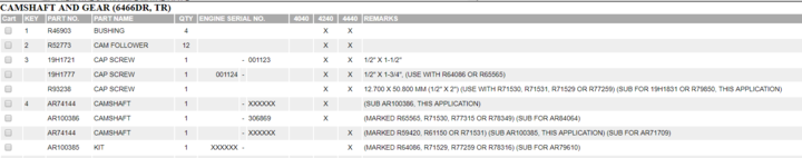

Tx Jim
Tractor Guru
Joined: 14 Feb 1999
Posts: 26201
Location: N Central Texas
Report to Moderator
PostPosted: Mon Jan 21, 2019 7:07 am    Post subject: Re: 4240 difference 466 vs 4440 Reply to specific post Reply with quote
Engine camshafts for 4240 & 4440 are different according to parts catalog
Back to top
