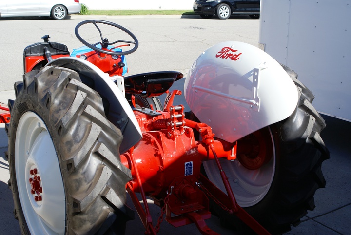

Hello,
I've been looking for an 8N for about a year now. I finally found the one I was looking for in Lakeside (near El Cajon, Ca.)
A little about me. I like old stuff ! I've restored tons of stuff all the way from 60's vintage Camaros, Chevelles, Mustangs to a couple of military vehicles and recently a Monarch Lathe.
So what can the experts here tell from the pictures? It runs, it moves forward and backward, the hydraulics work. The gas tank and the carb were very bad. I have a feeling it sat for a very long time before I got my hands on it. The gas tank was the worst smelling gas I've ever smelled. The original carburetor is tucked away for future resto. It has a 51 date stamp on the tag so it might be the original.

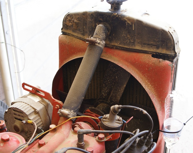

Is there supposed to be a thermostat in this hose??

That looks like a very solid base for a restoration. Yes, there should be a thermostat in the upper
radiator hose. Some come with a replacement hose and clamped in place with either a band. Other hoses
required a thermostat be inserted and a hose clamp added.

I would get it up and running use it before I dug into it deep... The only thing that popped out at me was the way they mounted the coil its not a deal killer the coil is mounted different on a original side mount dist head so I would guess the head has been replaced..
On the rear top link rocker for the tree point never use the top two
holes block them off so no one else does...

If I had to speculate I'd say the engine had been recently rebuilt before it got parked. I ran compression test yesterday and it turned out to be 90 PSI +/- 2 PSI on all the cylinders. I've never seen a compression test that was that closely grouped.
I will look into the coil mounting, the bracket that's it's currently on is very wimpy so I had planned on changing that anyways.
It will do what the big Kubota front end loader that they already have can't or go where it won't fit. I understand that a N is not a front end loader. It'd be great if it was but oh well. Right now I see it's job as
1. Dragging the arena
2. Working in the barn aisles as a platform to haul all the muck tubs to the dumping spot.
3. As a platform to feed off of.
2 & 3 will of course require me to build some type of trailer or I've been rolling around the idea of making a platform that attaches to the 3 point. Kinda like a variable height bed on the back of the tractor. Sound feasible?

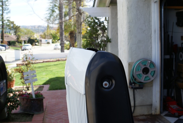

The "thing" hanging off the dogleg is the temporary gas tank. VERY temporary. I already have a replacement gas tank/filters but at this point it's not worth changing it out.
