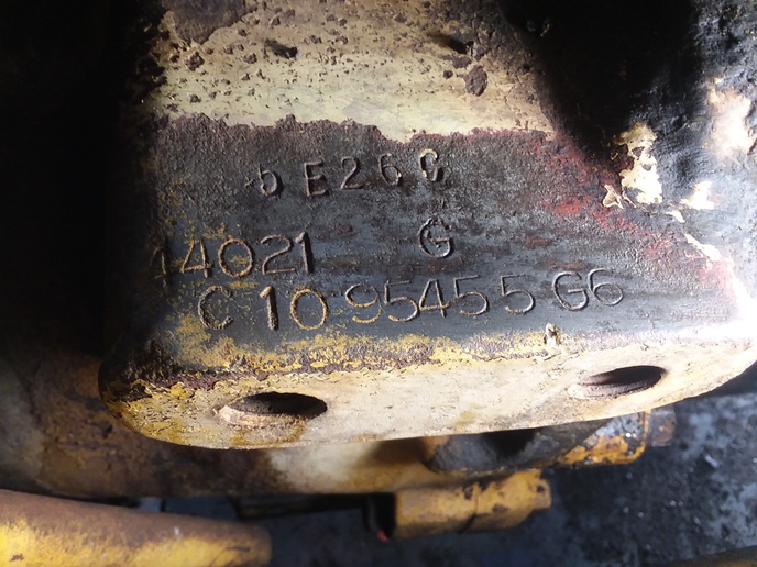

here are 3 pics. top pic is right side above starter with 3 sets of numbers , then next pic is the opposite side of bell housing { left side } and there is just 1 set of numbers 70A18 P ...and 3 pic is of the engine block , right side lower . I just pulled the motor to replace rear seal leak. it has a 740 loader , 753 hoe , cartridge type oil filter , power steering cylinder is mounted in front bolster , Non adjustable industrial front axle , gas motor , cast iron oil pan. 13" clutch. any help would be great.

My data book tells me its a 1965 model,, the stamping above the serial tells me its a 4400 model if I remember my years of working at a Ford dealership correctly

44021G
4 = 4000 series
40 = utility
2 = gas engine
1 = no pto
G = 4x4 manual reversing trans
5E26C = build date May/26/65 on afternoon shift
