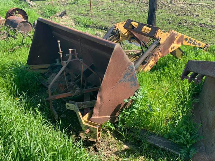

I am not able to determine without the serial number of the photo....anyone familiar with that and will that fit on a Ford 3600? Thanks!

That's not a Ford loader, and there doesn't appear to be enough of a frame to mount it to a 3600. Most loaders that fit a 3600 have frame arms that extend back to the rear axle. That one looks like it is made to mount on a frame that is already on or part of a tractor. Looks like the brand name is Du-Al. I can't find much about them on line other than used ones for sale, but I can't find any that are on a 3600.

That looks like a loader that would fit on a 3600, it's just missing the sub-frame. Those model loaders did
not use a sub-frame that extended to the rear axle, and they were definitely not considered heavy duty.

I see the frame in the weeds connected to the lift boom. And I think I see part of the rear mounts in the left side of the bucket. However I cant tell if this is a "compact loader" or the next size up. I would be trying to find the tag with the model number, and also see if all the mounting hardware is there.

A lot of those loaders were universal fit, but you had to have the bracket for the tractor you where putting it on.
Example - My Farm Hand 22 loader came off of a 240 Massy, I had to find the correct brackets to mount it on my 4000 Ford. It would take a different set of brackets to mount it on my 4000SU

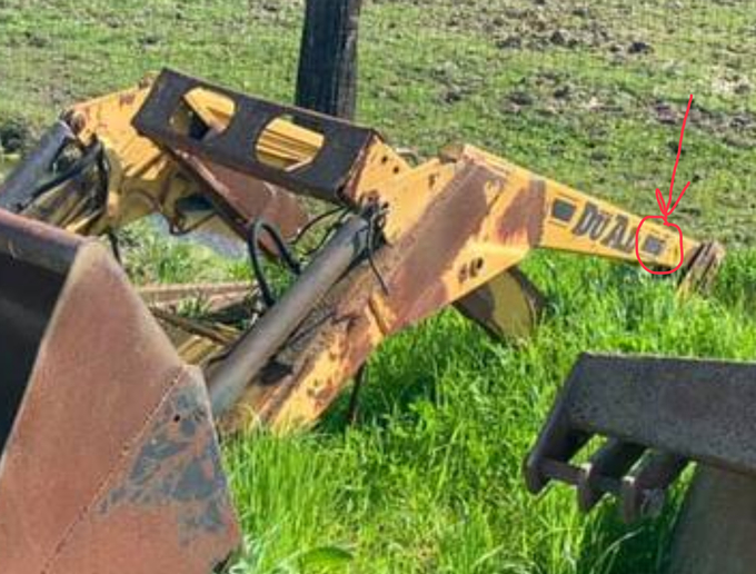

What is this number here?

I am waiting on that information from the owner....will let you know once I get it. He's not at the location all the time. Thank you.

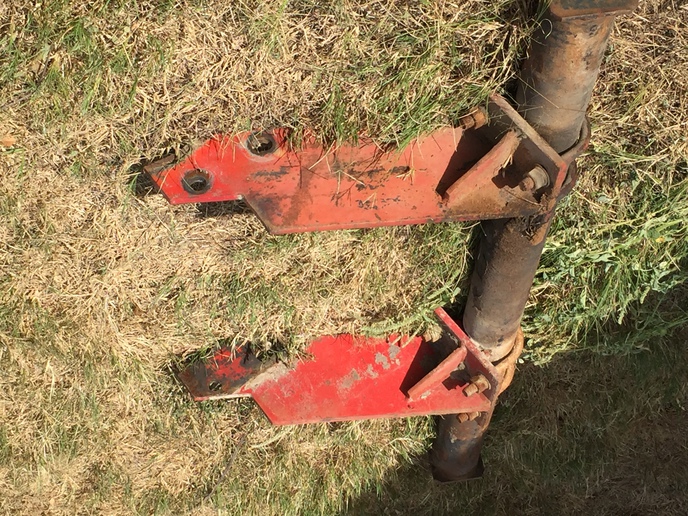

see if these pics make it,, a front mount and a rear mount for a different ford.
Back to top
View user's profile
sotxbill
Tractor Guru
Joined: 14 Jun 2003
Posts: 6311
Report to Moderator
PostPosted: Wed Mar 13, 2019 5:17 pm    Post subject: Re: Front Loader - Fits Which Tractor? Reply to specific post Reply with quote
These are for a bush hog loader and a ford 4000 or bigger. But never the less, they are somewhat similar to what mounts might/could look like,,,for this loader.

I was questioning that it was actually for a tractor or a skid steer. I can't see the lift cylinders or where it mounts in the rear.
