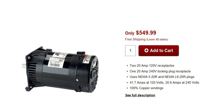

Belt-driven Pincor generators were once available to install on Cub Cadets using the front end PTO mount. A QA42 snowblower mount may be a good start to building a platform for a belt-driven generator like this one available from NT. Your IH 129 would handle 5000 watts - requires 11hp and 3600 rpm. It's safe for electronics, has +/- 5% THD rating. Probably more practical than rigging up a large inverter.

6.7 hp to get your 5kw, plus 10-20% loss for efficiency has you up at 8 hp. 11 hp requirement would leave you 3 hp for transient loads, make for a very
good power source to drive through things like compressor starts pulling on the generator. If you can stand the price, sounds like a winner. I bought
quite a few things from NT and their ratings worked just fine for me.

You can get 120 AC volts the hard and complicated way or the easy, clean and simple way.
Get a Fabco Powermite 110, it even looks exactly the same as a Cub Cadet starter/generator.
Paint it the CC yellow and everyone would think it was a factory option.
