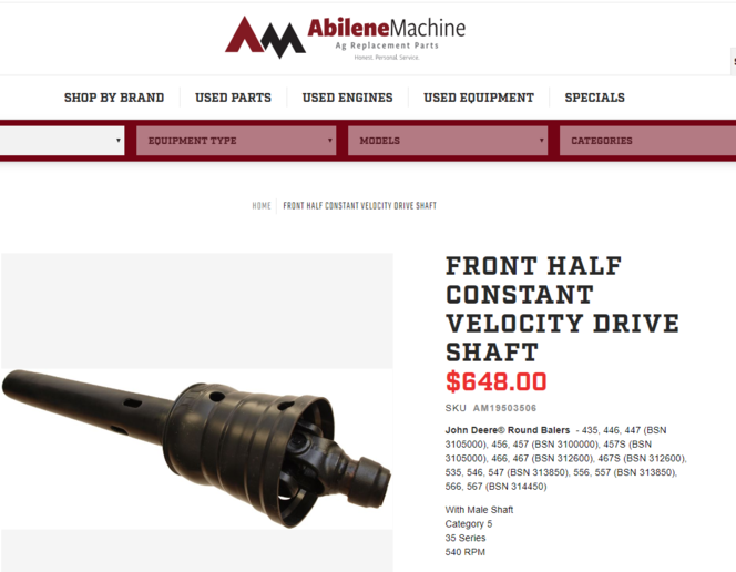

I have this baler and I think that big heavy thing on the PTO shaft that hooks to the tractor is going bad. It seems to be loose in the u-joint area that hooks to the tractor. I don't think it's the u-joint it self. Can I go with a regular PTO shaft? I don't think I will be using to much longer, having my right knee replaced the 2nd of April, don't know how long I have to take it easy. No warranty left.

I experimented baling with driveshaft that I converted to single u-joint several yrs back on my 467. I ground down indexing(timing) tabs so I could time the 2 telescoping shafts correctly. Baling in a straight line was fine but turning corners with pto engaged I could see the belts flopping due to the minor changes in pto speeds when pto shaft is operated at an angle. I'm fairly confident the chains were flopping also. I bought a new aftermarket shaft. Cheapest complete CV shaft I've located is $648

Thanks Jim, I looked around for a little while, didn't see one that cheap, most at least a $100.00 more, still better than a new from Deere.

This is the shaft I referred to.

Just a thought --- Are you sure you just don't need bearings at the coupler (where the 2 shafts come together)? I ask because my JD 347 sq baler ate that bearing last year. The replacement bearing is way cheaper than a new shaft --- even if you buy from JD dealer.

Drive shaft u-joint on JD 347 & 467 are not similar. 467 has CV joint with 2 u-joints very close together with a ball & socket joint.
