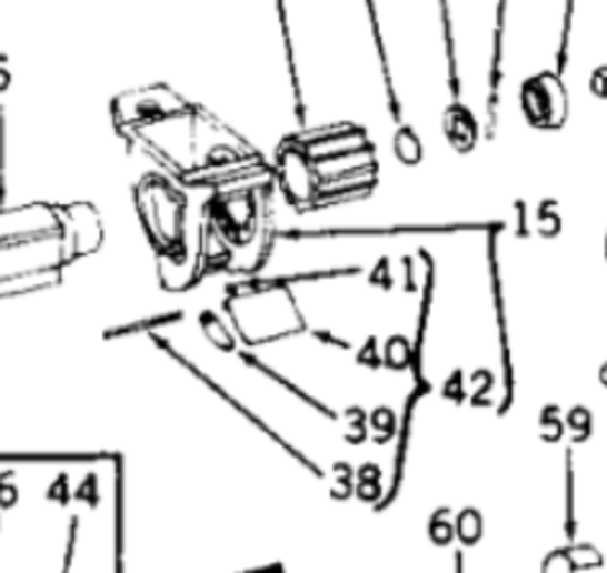

where’s can I find seed cups, i think most of the “flappers” are gone

(quoted from post at 17:36:37 04/13/19) where’s can I find seed cups, i think most of the “flappers” are gone
By chance when you state flappers are you referring to feed gates(key 42)? If so part# is as follows. I can't believe the price of a little piece of tin & small rod.
BB921M DOOR,LATCH, & PIN ASSY, TRAP ADD 30.82 USD

And when you have to change settings for different seeds plan on loosing a lot of skin as I mever found a wat to change positions on them without loosing that skin. Had to change them both spring and fall. What I hated the worst about that drill, that is why I was going to get rid of it.

After getting to where I can see a few of the seed doors/ feed doors It s probably best to replace them. Question is, how do they remove? Is it possible to make them?

Find yourself a extra drill in a scrap yard, plenty of them, turn it over so you can easily see the bottom and just start removing parts untill you can get down to them and then when you try to take apart you will know how they are put in and hopefully you will find enough good parts to repair yours without going and buying a second parts drill. Never heard of any aftermarket parts for any grain drill. I guess the new no-till have them but not from the 40's or 50's.
