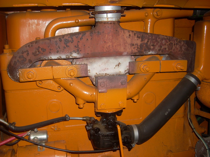

What did you use in the weld process?

I picked up this manifold at the Le Sueur swap meet years ago. Not sure what MM tractor it originally came off of, but I put it on my UB and it works great.
My other UB and my UTS both have this manifold:

1938-41 U will fit but smaller throat. 1942-57 U or UB all same. M5/M602/M670 336 gas will also fit. All 21-32/FTA/Gt/GTA/GTB with
403 motor also. Some new Chinese manifolds one have created issues with governor.

Dennis,
The rod is cast iron in stick form ,use with flux and oxy/acet
torch. Preheat as necessary ,shapes are not bad to weld, flats you
will preheat and post heat or they will crack.
