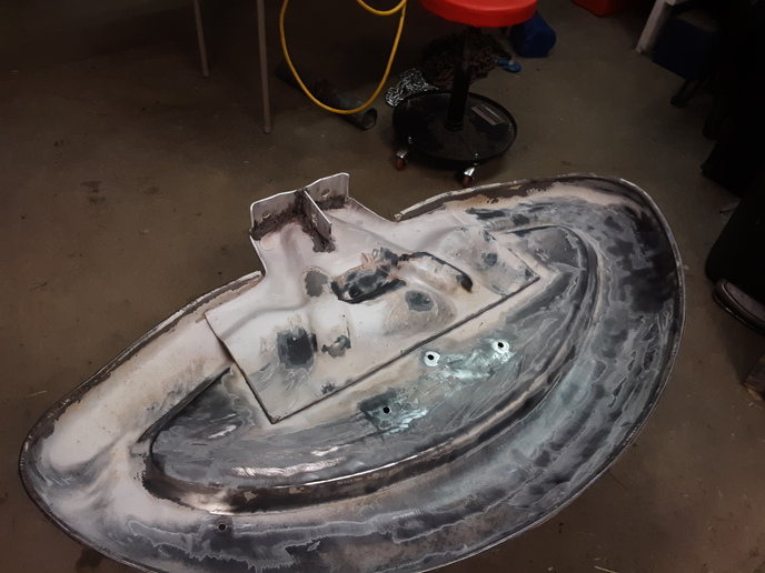

FIRST OF ALL, Thank you to "unc" for suggesting this idea on my previous post.
I had previously posted about air requirements for sand blasting, and a small blaster was recommended. It's handheld and has a media hopper right on the gun.
This picture shows what I could get done with two charges of air in my 24 gallon compressor that stores at 135 PSI and the output regulator set to 90PSI.
I'm happy, because this is exactly what I needed: the ability to get into crevices. As a matter of fact, it cleaned this fender crevice and exposed a crack at the root that I'm going to weld. When I welded, the blaster was just as good at getting back into the crevice for slag cleanup before priming/painting. PS...it's a good thing I was wearing protective gear, because blasting after welding equals HOT SAND flying all over...
PPS, my estimates of run time vs air recharge time using the ideal gas law (PV =nRT) were just about right on the money.
With my system (24 gallons, 135PSI, regulated output at 90PSI and 4.0SCFM pump) I got about 15 seconds of blasting with a 30-45 second run time to recharge.
The blaster is a Neiko 30068A, $35.99 on Amazon.
This is not an ad, just an evaluation.

Looks good. That's a nice finish. unc

That was initial cleaning.
After cleaning, welding the crack...adding a reinforcing rib made from a piece of lawnmower blade, then blasting all the welds (and all the other crevices on the fender) with the handheld blaster (which took about ten blast/ recharge cycles)...
We wire-wheeled the rest of the fender enough to get the loose paint and rust bubbles.
This was all that I wanted to do, get a surface ready good enough for some rust oleum and krylon.
