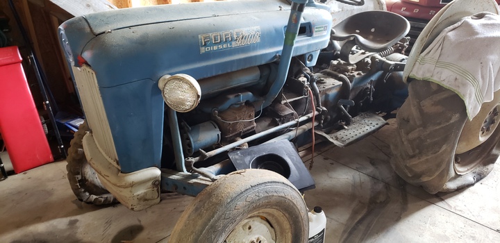

Wifes grandfather's tractor, hoping to start restoration soon. Sheetmetal vs serial number has me stumped.
Top numbers appear to be 84_
Bottom numbers appear to be 13890
Cyclones from hood, with missing emblem.
Cant wait to hear what you guys know.
Thanks

Its a 841 repainted in "new" colors, old dealer trick to sell old model or claim newer when selling as used. In top radiator tank by mfg there will be a date. Will give idea when built.

The diesel air horn box is the earlier one around 1958(the diesel came out with the 601s/801s in 1958) Rear axle is the earlier one before the 4000s came out. The grill is 600,601 or 800 and not the 801 or 4000 style grill. There are also differences with the fuel tanks between the 600?gal, 800?gal, (601/2000-13 gal) and (801/4000-17 gal). But it might be a very early 801. There are casting dates on the engine, axles trumpets and other parts. The engine code will tell if it's a 144(601/2000) or a 172(801/4000) and roughly when it was manufactured. When all the right parts are there, then I feel obligated to keep it right, however when it all mixed up then I feel free to make it whatever I want. Add power steering,Sherman, remote connectors, 12 volt alternator, cab, loader, backhoe, winch, snowblower ... etc! Then I paint it black and put SS 396 all over it. Your looks like it has not been messed with, still has it's generator. Well congrats on the tractor wish you all the best. Personally I think the 801s and the all red 601s were some of the best looking tractor ever build.

Stealth you have very little to worry about. The four cylinder four thousand has only very small differences from the 801. Yours appears to be very close to original except for the paint and the grill. It should be a very straight forward restoration. If you want help with what colors to paint parts, I have a Ford brochure with actual color photographs from 1958.

Since it has a 601 style grill and an 841 model number stamped on the transmission, it is likely that some parts have been replaced from the original, so it could be an 841 with the sheet metal replaced, in which case it would have a 172 ci diesel engine, or it could be a 601 series with the transmission swapped out, in which case it would have a 144 ci diesel engine. Find the raised casting number on the right side of the engine block to figure out which engine it has. Here is the breakdown on the casting codes for the various 1955-1964 engines.

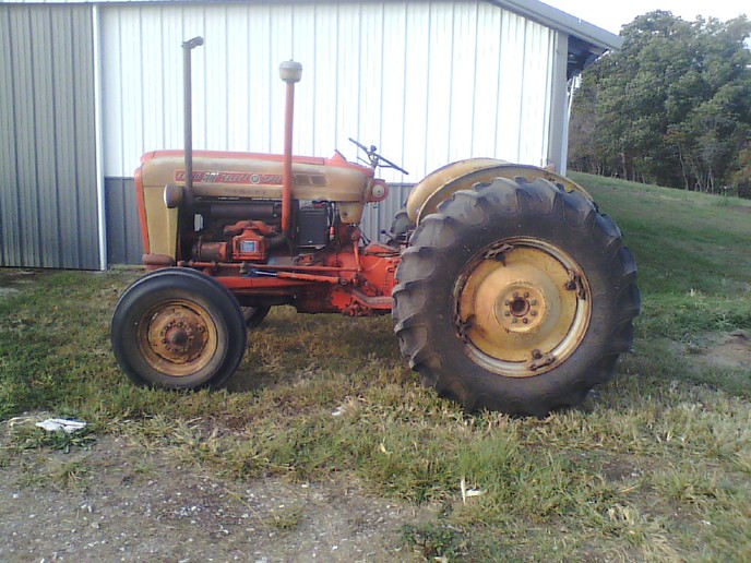

Here's a photo of my 62 model unrestored 801D.
It has SOS trans but should give you and idea of the colors and sticker locations.
I can post other photos of all sides if you need.
