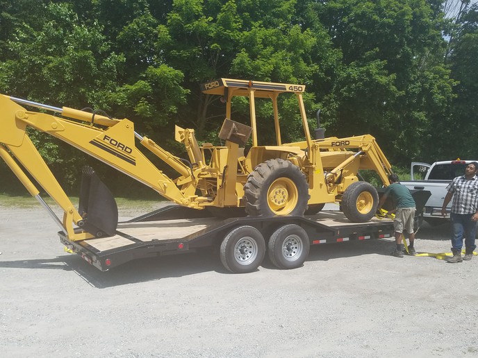

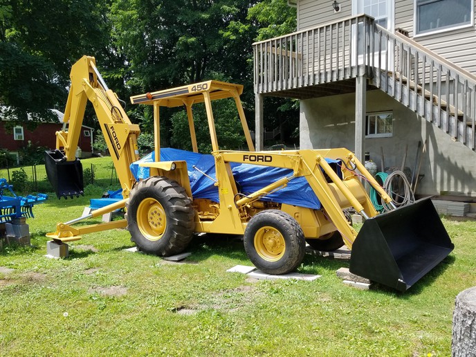

PostPosted: Sat Jul 13, 2019 6:42 pm    Post subject: Re: Service plate leak on 1987 ford 450 loader backhoe Reply to specific post Reply with quote
Back to top
View user's profile
Romi
New User
Joined: 10 Jul 2019
Posts: 6
Report to Moderator
PostPosted: Sat Jul 13, 2019 6:44 pm    Post subject: Re: Service plate leak on 1987 ford 450 loader backhoe Reply to specific post Reply with quote
Back to top

Looks like it's been recently repainted and it may have had the dash panel swapped out at some time.
Ether way it's a nice looking machine and sounds like you got a good deal.
I'd use it and keep a watch on the transmission oil level, if it doesn't leak bad I wouldn't mess with it, it's a pretty big job splitting one of those tractors.
