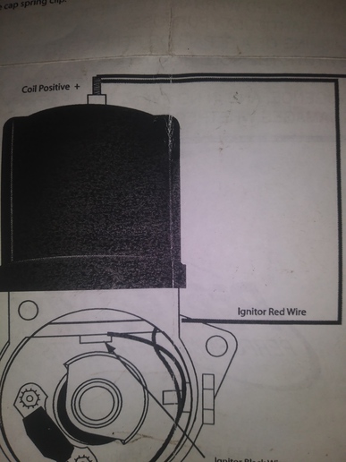

I built an EI set up with a Ford 2.3 reluctor and Pickup going back to an HEI module
[img]https://jtvltg.dm.files.1drv.com/y4md1u1ldUR8kJY87zJosUiUOqdMgoEB5l_sb0XYb9XuMuCwlENUXmBdGjPztaMpNAZRsbX9IDviS1Bl-8RGtQ_fkbaAcUjiM_WQdMqQX2ctC0GxB2i4drps0YF-oe-jX045NmGb7gd1kt7cy6QiCwoOIpIt6RJquHnQAiA5kfOe5pD2W-5fxnFOZj9t3IEerWovzh5ZaHMNN54mg0OOUC_0Q?width=1620&height=1454&cropmode=none[/img][img]https://h5sgiq.dm.files.1drv.com/y4mnWRNsYm8njtLHd-3lACyLAHo7-ueaHyDwv54EHfwTRolf6o9cY3JifxT83DE3H7lIPKXgcHMoNtsfqVaTfTKfIpNbrEST2UCIGq-HJy0pbSeJysPIOa1H2RSErAiVzNwMLy3nAZe5MtTzBVq6k0-HRa_A7TJt0LDCeD1i9bT3IOYa-jExjD7qTrNCGDkKU-qyOXnjACZnQ20WRZt1FkhIQ?width=2639&height=2055&cropmode=none[/img]

I doubt they could beat this for price or performance. This is my "proof of design" cover made from some Delrin (acetal) sheet/rod and a few bits of common OTS hardware. The HT tower screws into the top cover. The tower has an aluminum sleeve and simple spring loaded contact point in it that makes the HT connection to the OEM cap in the same fashion as the OEM coil so there is no need for modifying the cap. The backside of the cover is also relieved to clear the condensor so it can remain in the distributor if you are staying with contact breaker points. All that remains is to add a provision for the primary connection and a means of clamping it down. Right now I am considering three options for the clamping system:
  1. Add a spacer to the cover and use the OEM bail
  2. Replace the screw that holds the primary connection to the points with a stud and bring it up through the top of the cover as a terminal connection point for the primary lead. The external nut on that connection would then do double duty and clamp the cover to the distributor.
  3. Add a couple slotted tabs to the sides and use self threading screws in the holes for the bail to clamp them to the body.
Right now I am leaning towards #2 because it is easy and does both jobs but I am open to suggestions.
There are a few other details to work out but nothing major. I made this one by hand but I will be ordering a batch of the top covers from a CNC shop along with matching rubber or rubber impregnated cork gaskets "real soon now". I just need to verify all of the geometry is right before finalizing the drawing.
Kudos to Bob and Hobo - this is is way easier than gutting a coil.

TheOldHokie wrote:
(quoted from post at 15:14:25 07/11/19)
I made an executive decision and went with an 8-32 stud and three nuts as a combination primary terminal/cover clamp. Clamps the cover nice and tight and with the addition of a quality gasket should outperform the OEM bail and cork gasket.
Everything looks good so I am going to put the approved stamp on the drawing and get some quotes for the Delrin pieces. Wonder if someone can supply it in Ford red Wink

#2) I don't like attaching the cover to the points post, how are you going to set the timing ?... I doubt it going to make much difference but the points plate is locked down and takes the option away for us that can set the timing with a light...
I would keep it so the dist cap can be removed if the dist needs to come off the engine... I would knock the upper vent out of the dist body and run the primary wire out to the coil...

Hobo,NC wrote:
(quoted from post at 20:52:47 07/11/19)
Timing was/is my biggest concern with #2. You can still set the timing but you need to bend the stud slightly if you move the adjustment way off center. I was going to have a short slot cut rather than the hole I drilled to minimize the need for the bend.
You can still remove the cap and/or the cover - both were hard requirements from the git-go. Another is no drilling or other modifications to the cap or body of the distributor. Setting the timing with a timing light was not on my radar How do you do that with the distributor on the tractor or is that a trade secret Wink
I considered using the condensor hold down screw rather than the primary post on the distributor. I'll have another look at that.
Keep the comments coming - I'd like to get it right the first time.....

PostPosted: Fri Jul 12, 2019 3:46 am    Post subject: Re: Bob's Front Mount External Coil conversion Reply to specific post Reply with quote
You have to Locate TDC then make are mark a indicator at the front crank pulley... THEN have a timing light that will work with 6/12V that does not pick up interference from those useless aggravating copper core plug wires...
Its just a matter of loosening the hold down screw for the points plate timing adjuster and moving it with a long screwdriver... I have done this with the tractor running...
Conversions like this are giving you the options to get deep into timing, dwell ETC Smile All these things to nail perfect operation of the front mount dist. to lessen the agitation its a win win even if you don't go the extra mile are tool up for it the option is there Smile
