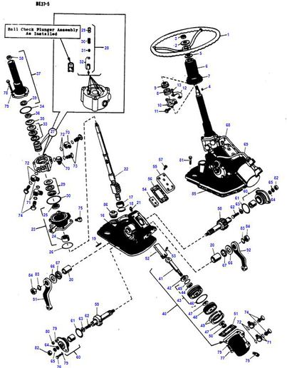

Hi all,
I m on the hunt for a power steering box for my Massey Ferguson 2135 but all I ve been able to find is one for manual steering and have been told they re not interchangeable. Any ideas on where to locate one?

The 2135 is the same tractor as the 135 for the most part, but power steering parts aren't cheap. I have a 2135 that had power steering, but the power steering parts were junk. The parts to fix it would have cost more than the tractors worth.

Well that s not good news... even just the box rather than the assembly? I think we can likely rebuild with a new box. Any idea where to find the part though?

Could find one used at a tractor salvage yard, there is two different styles of power steering.
Manual steering box:
Power steering box for use with the power assist cylinders on the front axle:
Power steering box with the power assist cylinder on the steering box:

The model with power assist cylinder also has 2 versions, one with a screw in power relief valve and one without. I read a post here awhile back that had a pic of the valve and after searching my non working unit to see if that could be my problem I found no valve nor no port for it.

The post with pic of the valve is way back on page 5 and was a post by Dreich.
