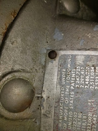

PostPosted: Thu Jul 11, 2019 8:40 am    Post subject: Re: Help identifying Ferguson TO tractor Reply to specific post Reply with quote
Here is the serial number plate. I'm not sure, it just says TO but not 20 or 30

PostPosted: Thu Jul 11, 2019 9:09 am    Post subject: Re: Help identifying Ferguson TO tractor Reply to specific post Reply with quote
https://www.yesterdaystractors.com/cgi-bin/snlookup.cgi?mf=FERG&md=TO-20
41412 should be 51 model if I am reading correctly.

PostPosted: Thu Jul 11, 2019 9:25 am    Post subject: Re: Help identifying Ferguson TO tractor Reply to specific post Reply with quote
OK, is this a TO 20?

PostPosted: Thu Jul 11, 2019 10:06 am    Post subject: Re: Help identifying Ferguson TO tractor Reply to specific post Reply with quote
is the oil filter internal or external ?

PostPosted: Thu Jul 11, 2019 12:02 pm    Post subject: Re: Help identifying Ferguson TO tractor Reply to specific post Reply with quote
The dash board is flat on a TO20.
The dash board on a TO30 has the air intake through the dash on the right side.
A TO35 has a hi-lo transmission, 2 shifters.
Unless its a Frankentractor...

PostPosted: Mon Jul 15, 2019 3:22 pm    Post subject: Re: Help identifying Ferguson TO tractor Reply to specific post Reply with quote
That is a 1951 Ferguson TO 20 using that serial number.
