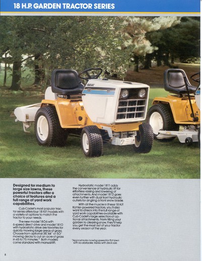

If you don't mind turning a wrench now and then, a good used tractor could be the way to go. Look for a good one from the 1980's with low hours and you can save $$$thousands over the price of a new one. Many of these were stone reliable including the JDs and Cub Cadets.
The one below and similar models (782, etc.) were the the high-water mark for Cub Cadet and extremely popular. There are still many model 1811/12s out there with 700-800 hours. The cast iron Kohler M18 twin is one of tne best garden tractor engines ever built, and at 700-800 hours still will have a long life if taken care of. All of the components on these tractors are 100% serviceable. No problem getting parts in general. A good supply is still out there for used parts. The newer Kohlers are not nearly as bulletproof and are designed to get horsepower at peak prm. Unlike the cast iron magnum twins and Onan twins designed to make power at mid-rpm so with those you can run at less than full throttle.
I really enjoy mowing with my 782, cuts absolutely great and have the satisfaction of knowing how little money invested (looks like new) compared to a comparable tractor new costing at least over $5000.
However I would avoid the Onan twins due to the aluminum cylinders. They were prone to damage from overheating, required extreme care to keep the cooling fins free of grass clippings, and strict attention to service intervals or serious valve problems would result.
