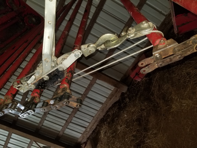

Hello everyone, we have a NH 847 Round Baler which broke a few links on the upper chain where the bale spins. it broke while the bale was coming out and it was a pain to get to a workable position. We tried using a come-along to move the links closer together but it still needs about 6" of movement, and it's going any more closer together. Is there some sort of way we can release tension in the chain and the rollers so we can get it functional again? My only other thought is to jam something between the door and the ground, and then work on it, but that sure isn't safe. Smile Any ideas or pointers will be helpful!!!

You have to release the tension on the big springs
on the back

You can possibly loosen the big springs to release the tension....however they are probably rusted so they wont move much, or easily. You are on the right track with
the comealong. That is how I replaced links in my chain. I put the comealong hooks directly into the chain links...a few away from the break and tightened until I could
put the link in.

The manual tells you how to release tension on the
springs It?s not hard at least on the 851 you position
the gate and then pull pins and it releases the
spring tension you don?t have to try and unscrew the
spring bolts . All you will do if you keep pulling with
that much gap is kink or break the tubes then the
whole chain will come out at high rated of speed

Since the break is where its at now I'd just get some heavy wood blocks and block up the tailgate of the baler and then pull the chain together.Make sure the teeth of the chains are aligned on the drive sprockets first though.Also inspect for any missing bolts in the bars,bent bars and twisted chain links.Could be the angle of the picture but the bar on the top
sprocket appears to be bent.Running the baler with bent bars is a sure way to have a lot of trouble.
