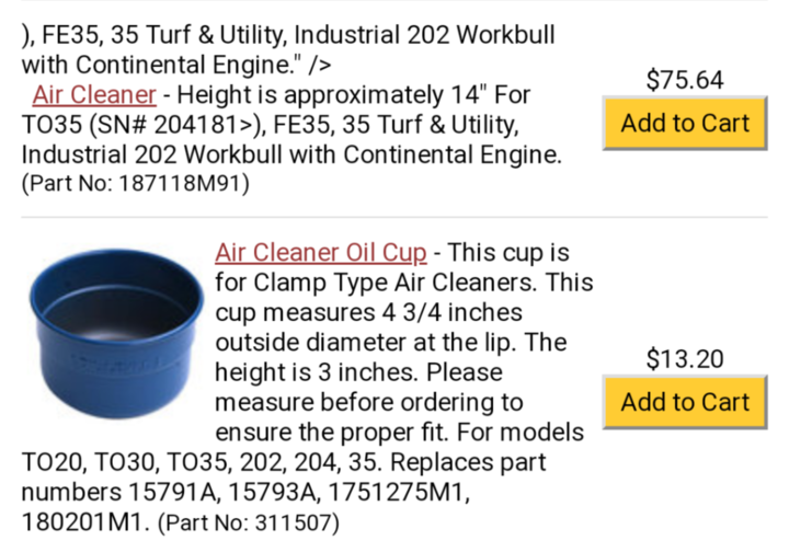

I'm loading up my cart with parts I know already that I'll need but when picking out my missing air cleaner I didn't see an option for the connection pipe to the carb? This here:

Also can anyone tell me if the air cleaner comes with the bowl or do I need to purchase both?

Jim.ME
Long Time User
Joined: 02 Mar 2018
Posts: 1054
Report to Moderator
PostPosted: Tue Aug 13, 2019 6:14 am    Post subject: Re: MF 202 WB Reply to specific post Reply with quote
Black Flag Forge wrote:
(quoted from post at 09:54:24 08/13/19) Also can anyone tell me if the air cleaner comes with the bowl or do I need to purchase both?
I would call the vendor and have them confirm how it comes.

PostPosted: Tue Aug 13, 2019 7:01 am    Post subject: Re: MF 202 WB Reply to specific post Reply with quote
It's from here, was kinda hoping a rep might pop their head in lol.
