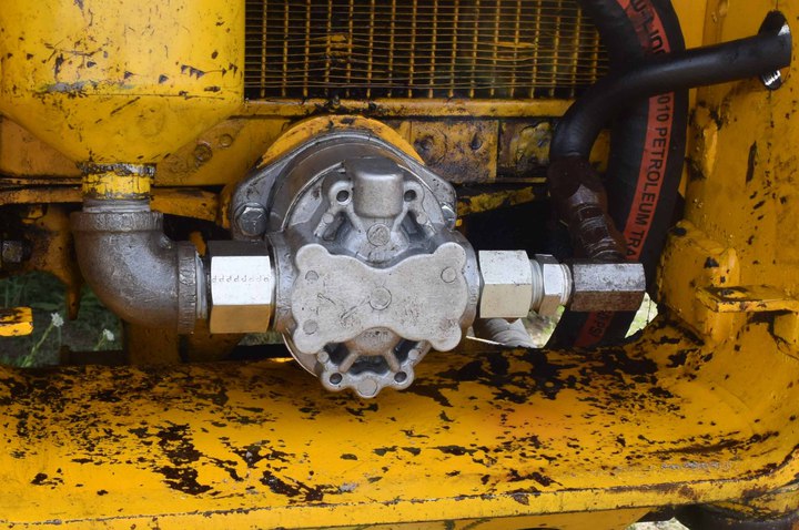

Hello
Does anyone know where I can get the pump body part # 400297m1 is the Massey # or a pump for this loader
Or if the one they sell here will work Part No: 40P018LAJSA
Thanks
Wilf

I have figured out the L827-10X-LB pump mounts the same and has the same shaft it is just less gallons per minute.
So I going to try it
Thanks
Wilf

How much less gallons per minute, less gpm the slower the loader will work.

It runs 14gpm in stead of 17

14 gpm is the minimum I'd use on a FEL.

Well the L827-10X-LB hydraulic pump works great on my 63 MF 202 ind.
A couple things that will need to change
the mounting bolts to 7/16 x 1 1/4, also had to change the plumbing configuration on the filter.
It might run a bit slower but nothing that is really noticeable.
I hope this helps other people, I know I had a real B@#$% of a time finding one that would work.
