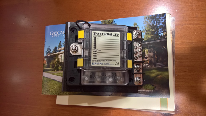

When a fusible link blew on my 92 Dodge I decided to replace them all with fuses. I used a marine grade fuse box.

Great idea. Do you know the amperage rating on those fuses? I finally installed a 50 amp circuit breaker on that wire. Works just fine.

PostPosted: Wed Oct 09, 2019 8:38 am    Post subject: Re: Fuseable Link on 1994 Chevy 3500 Reply to specific post Reply with quote
There is a color code with the amp rating for the fusible links, I just replaced each fusible link with a fuse of the same amperage.
I will see if I can find a link to the color code and post it later today.
BTW - The fuse panel I used did not include any fuses.
