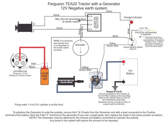

By the way, here is a very good wiring diagram I found on the web for a 12v neg ground system.

Thanks for sharing this schematic.:)
