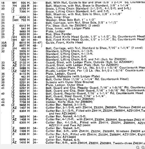

According to my manual it s a Z 5231H for the "regular " sickle bar. Looks like it changes based on the crop type. I don t mind adapting one to fit if it s reasonably close. It s just a cosmetic thing for me, the bar looks like it s missing something without it there and I wouldn t mind adding the grass board as well.

Thank you Hay maker2. I just got a parts manual for it the other day in hopes knowing the exact number would help. Thank you for posting it though!

The part you are looking for is called an outer shoe.
The outer shoe for your mower, regardless of the model, is the same one that fits the No. 3 mower, No. 5 mower, and No. 39 mower.
I have interchanged the outer shoe on all three of these mowers.
Outer Shoe History:
Z-487 No. 1 and No. 2 mowers
Z-532H No. 3 (No. 1 and No. 2 cutter bars are the same as No. 3 cutter bars.)
Z532 No. 4 mower
Z 532 No. 5 mower
Z 532H No. 7 mower
AH 13580 H No. 8 and No. 9 mowers (Substitute for Z 532H)
AH 13580 H No. 10 mower
AH 13580 H No. 11 mower
AH 13580 No. 37, 38, and 39 mowers
Best way to find one is to contact David from Kansas on this forum or John Deere forum.
Hope this helps.

The shoe and subsole are still readily available from DEERE, by REALLY pricey.
If you GOOGLE AH13580, lots of sources will come up, including Walt's Tractors who shows a used one for $75.
You will also need the "runner" that goes beneath it, Z5231H, replaced by AE31366, he shows that, as well.
If no luck, post back, I can dig one up for 'ya!
