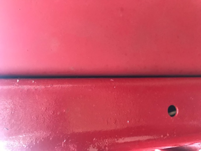

I cleaned these parts with a wire wheel on a grinder, wiped them down with acetone, and sprayed them with rustoleum primer. They were allowed to dry for 36 hours before I color painted them. I painted these parts with rustoleum regal red paint in a spray can and they had a very nice gloss to them that was almost flawless after applying 2 coats of paint. They then dried that evening and overnight and I noticed they had A dull finish about 24 hours later. I do remember that there was a considerable amount of dew on the parts the next morning before the sun dried them out. I m not sure what caused the finish to go so flat and dull, but I ve painted many many parts and items just like this before with no problems at all. The battery box side is shown installed so you can compare it with the rest of the parts that have gloss.
I know I can lightly sand and repaint; but I would like to know why this happened so I don t repeat it.

It's called blush. It's when moisture from the air literally gets into the paint and comes to the surface screwing up the sheen. You have to watch humidity levels when painting even using a brush. Generally
the faster drying the finish is the more prone to blush it is. I don't paint when the humidity is above 70%. When it's border line you can add additives to the finish to slow down the drying time. Assuming you
used an oil based enamel you could use Flood Penetrol to the paint.

I learned something. Thank you. I ll keep that in mind next time I m shooting paint with my hvlp for sure. What should I do to fix these parts?? Do I need to scuff with sand paper and just re-spray?

I would agree with Stephen.
I use gun and can mix in different speeds of reducer to get the drying time wanted.

The only fix is to scuff sand and put another coat on. Just be sure to wait until the weather is better.
Had you used lacquer it would have blushed so bad the color would be pink from the water.

Parts got hazed from humidity or actually water from condensate right on them . Just scuff sand lightly and shoot more paint.
