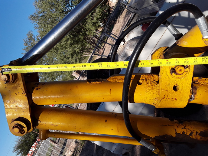

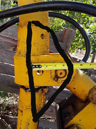

Hello,
I have a Sherman 54B Power Digger that I am going to repair it with the original pipe design. I will likely go 1/2" wall instead of the original 3/8" wall. The arm has been patched many times. If someone with an original model would post the measurements shown in my photos I would really appreciate it. Center to center of the pins and center of pin to pipe.
Thanks, Chris

not sure if it's been mentioned, but i'd think about using square tube. that would allow for a better joint design for the center cyl mount. welding around the pipe for cyl mount is asking for trouble. in any event, that looks like a fun job. I would take the boom off, and build a complete new one.

Square tubing is stronger and I believe the next model was square. I am looking for 3 1/2" diameter 1/2" wall about 53" long.

I would redesign that section using 6x8 square 1/2 in wall tubing , just redoing it back to how it was IMHO is a waste of time and money

To each his own. Do you have any measurements to share?

For lack of getting any "original" measurements, it looks to me that the measurements you are getting will be very close and should work just fine.

I appreciate the tip. For a 52" piece of 3 1/2" od - 1/2" wall I have a quote of $245 delivered to my home.
I suspect the arm maybe shorter and the pivot too short. The unit worked in it's current dementions but for all the butchering done to my back hoe I am still looking for the OEM measurements.

Post closed. I am going to give the benefit of the doubt and say no one that has seen this post is familiar with this rare early back hoe. Pictured is how I am going to repair it and add an inch to the pivot. Hope this helps the next guy that comes along.
