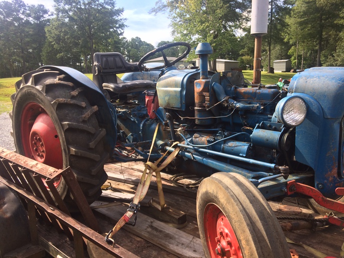

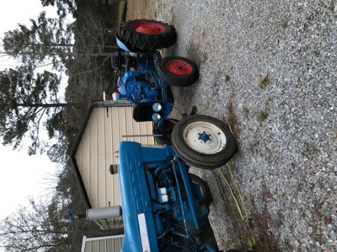

So, going to post a couple of pics of my other "beast", that is my main squeeze...
Yep..I'm a Ford man alright! "Glenda (Dexta) when I first brought her home..
Giving the Old girl a face lift..Next spring I hope to finish!
