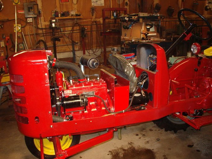

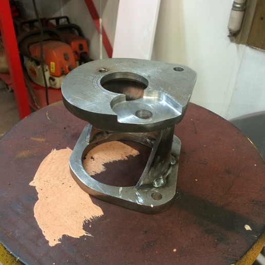

Anyone have closeup of middle of Earthmaster? Need clutch area and starter
picture.

Have parts manual but very hard to understand. Need to see how starter is
mounted and to what. Also cover for clutch. Parts missing like bulkhead and
clutch cover. Have tool box.

My tractor is in storage for the winter and I've been looking at my picture but can't find any of the area your asking about you might join the yahoo earthmastet group there are 100's of photos posted you may find what your looking for, there is an adapter that bolts to the engine block and the starter is bolted to it, there is a firewall but no cover over the flywheel here's a couple of picture of a st5arter mount a fellow fabricated

PostPosted: Sat Nov 30, 2019 4:25 pm    Post subject: Re: Earthmaster C Reply to specific post Reply with quote
I found these pictures of my tractor maybe of some help

PostPosted: Mon Dec 02, 2019 10:26 am    Post subject: Re: Earthmaster C Reply to specific post Reply with quote
Thanks for pictures. So bulkhead and clutch covers are just tin?

PostPosted: Mon Dec 02, 2019 11:05 am    Post subject: Re: Earthmaster C Reply to specific post Reply with quote
Yes looks like the bottom of the toolbox covers the cltch flywheel
