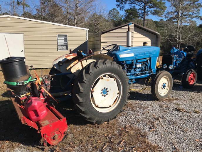

PostPosted: Thu Dec 05, 2019 7:55 am    Post subject: Re: Fordson Dexta Has Diesel in the Oil Pan!!!!!! Reply to specific post Reply with quote
n
Ok here is the latest. I left the drain plug out of the oil pan with a bucket under it to see if any dye colored oil would show .
The next evening I found maybe a cup of dyed fuel with a soot color to it also. Crap! So, after some fine wine..I decided that I could have residual fuel in the crankcase, so I left the bucket there another day. So, last night I looked into the bucket and it was just a tad of oil so I was right and that residual fuel just had to drain out.
So, I put a new oil filter in and new oil. Sprayed the injector pump springs, etc and put the plate back on the injector pump and decided to crank the old girl before it got too dark.
Well, crap again..no joy..the system has been bled really good, so what now?
As I was cranking I notice puffs of really fine mist coming out of "somewhere" around the pump area. Its dark now so I got a work light and saw that the plate that between the exhaust ports was spewing diesel. (really fine mist)
So, what does this plate cover and is there suppose to be fuel in there and since it is leaking could that keep the engine from cranking?
Lastly, to DL..I'm in east central Mississippi.
Another shot the "Beast"..It was sold to me as an "English Ford 3000"..It had turn signals, etc at one time. I completely broke it down, had the engine rebuilt, new clutch and sanded and repainted it..back in 1992. After I get through with "Glenda" I'm gonna clean put another paint job on it and repair a couple of greasy spots. I call it the Beast because of the pure power it has for such and old tractor..
Thanks,
Shep

PostPosted: Thu Dec 05, 2019 8:49 am    Post subject: Re: Fordson Dexta Has Diesel in the Oil Pan!!!!!! Reply to specific post Reply with quote
What you have is a leak on the pre-combustion chamber covers, they can be
s-ds to seal at times. there is only a thin copper gasket and you have to
make sure the surfaces are clean. You will get a mist of diesel because
that is where the injectors squirt into. Once she is running you will see
a little smoke.
I would get her started and warmed up then go around the three studs and
see if you can get them a bit tighter and seal the leak before stripping
the plate off. If that fails, take the plate off and clean both surfaces
well before reassembly. New gaskets/copper seals are readily available
from any Massey Ferguson (spit spit) dealer as the MF 35 and 135 use a
similar engine.
You may not get her to start easily if the glow plug and fuel primer in
the tap is not working. Diesel sprayed on to the glow plug burns and
causes a flame in the intake manifold which is drawn into the cylinders
and fires her up. In some cases you can get away with not having this
system working in hot climates, but for me, any indirect injection engine
like the Dexta needs either glow plugs in every cylinder or the flame in
the manifold. Working on early Perkins engines, on which the Dexta engine
is based, on cold mornings we would hold a burning diesel-soaked rag over
the open inlet manifold to get them to fire up.
40 seconds on the heater, two pumps on the primer, listen for a "pop" in
the manifold then hit the starter and away she will go.
Back to top

PostPosted: Fri Dec 06, 2019 5:29 pm    Post subject: Re: Fordson Dexta Has Diesel in the Oil Pan!!!!!! Reply to specific post Reply with quote
Thanks you 2 guys for chiming in...So, First I have never used ether on this baby and will never so lets put that to rest..I understood the PO did, but after I went through her she would crank without anything except a good battery! So, My worries about the ether although were well founded...it seems that she may not have suffered any long term damage..
This combustion plate thing is driving me CRAZY!! I have maybe 6 new copper gaskets on hand and I have yet to get this leak to stop.
I read about annealing the copper gasket which I did and that didn't work!
Ok, so the attached photo will show a small patch of where the fuel is coming from so..As best I can tell..But what sets my hair on fire is that this did not manifest itself until months of her running great and cranking with only a few turns of the starter...
Anyway, thanks to YT parts I have a replacement combustion chamber plate in transit..so, Jeeez..we will see when it comes in what happens...
Ok, guys,,the question for now is should she crank with this leakage? She is not even trying to come back to life while cranking..I have confirmed all 3 injectors have been bled ..
Thanks guys!
Shep

PostPosted: Sat Dec 07, 2019 12:30 am    Post subject: Re: Fordson Dexta Has Diesel in the Oil Pan!!!!!! Reply to specific post Reply with quote
That would be fine DL. Reading back, I get the feeling that the tractor
was running OK until it was stood up. Water in the injection pump probably
caused the plungers to stick and, even if they are moving now, water/rust
on the plunges can cause a lot of damage. We are talking very fine
tolerances in there and damage can occur within a few days.
My priority would be to get it running then you would find that the pre-
combustion chamber leaks would possibly disappear. Coupled with a bit of
hard work to get the carbon and gunge out of the system.
If someone has been using ether it is also possible that there are
internal problems.
What are the chances of a tow start? If she is misting diesel out of the
chambers she is obviously not firing and a tow might just be enough to
build up compression and start her off. I would also try a whiff of ether
just to get her running again.
