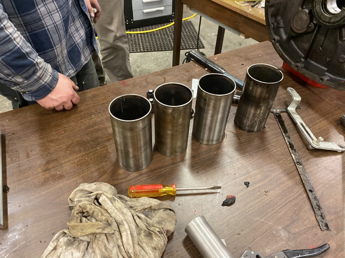

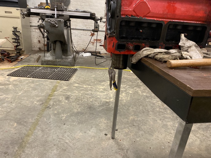

We're in the middle of rebuild this motor with cast sleeves. Seems like someone was in there before us. Three of sleeve that came out took at least two minutes minimum, cylinder # 3 took 30 seconds. This block is bare as it gets (there's still the oil tub in the block besides the paint on the outside).

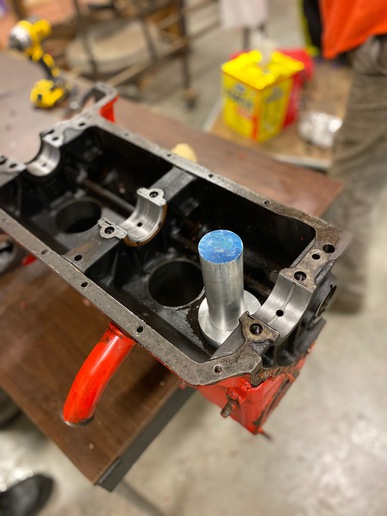

In the last post was a picture of the middle main bearing.
We though the sleeve was cracked, but we didn't see anything.
