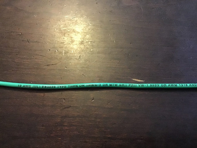

Is it ok to use 12gauge wire instead of the 16gauge? I have quite a bit of 12 awg type THHN/THWN and just a small amount of 14 awg. I have the 10awg for the alt to ammeter just wandering do I need to purchase the smaller size?

Larger wire will work fine.

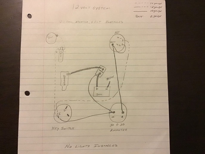

This is how I wired the system, does anyone see any problems?

Taking power for the ignition (and lights?) from the battery side of the ammeter means the ignition (and light) current will show up as a charge when the alternator is working, and not as a discharge when it isn't. Not necessarily a problem, everything else will still work except the ammeter won't be as accurate as it could.
Also, when I did this on my antique car, I found that the 30 amp ammeter would peg to the charge side after every start. It seemed to be slowly damaging the movement, as the needle started to stick. The easy solution is to change to a 60 amp ammeter; but I wanted to keep the original for appearance sake. So I came up with a shunt to recalibrate the original ammeter to roughly 60-0-60. Just a piece of copper wire, with the length chosen to match the resistance of the ammeter.

PostPosted: Wed Jan 22, 2020 3:28 pm    Post subject: Re: Alt, amp, and key wiring Reply to specific post Reply with quote

PostPosted: Sat Jan 25, 2020 10:52 pm    Post subject: Re: Alt, amp, and key wiring Reply to specific post Reply with quote
Sorry about the photo, I'm not sure why it came out so big.
To get the ammeter to accurately reflect only current to/from the battery, just connect the feed to the ignition switch to the alternator side instead of the battery side.
If you want to add a shunt to change the range of the ammeter, you'll need to do some detective work to find out how long to make the shunt.
One way to do that is to find some load (I keep old headlight bulbs for this sort of thing) that will produce some deflection on the ammeter. Then play with different lengths of shunt, until you get only half as much deflection. In this case, wire size does matter, the heavier the wire you use, the shorter it can be. I would guess, as a starting point, somewhere around 4" of 14 AWG would work. If that doesn't give enough deflection, use a longer piece (say 6"); or if it gives too much, use a shorter piece.
The shunt just connects across the two ammeter terminals, so that part of the current runs through the shunt instead of through the ammeter.[/img]

PostPosted: Sun Jan 26, 2020 6:37 am    Post subject: Re: Alt, amp, and key wiring Reply to specific post Reply with quote
Thank you for that info, I thought about switching the ammeter to a 60 because of the alt. Have not decided yet. I did move the wiring to this.

PostPosted: Sun Jan 26, 2020 9:46 am    Post subject: Re: Alt, amp, and key wiring Reply to specific post Reply with quote
From your picture you may or may not have to use a diode running the back feed power from terminal 1 on the alternator through the ignition resister usally kills enough power that the engine will shut down.
