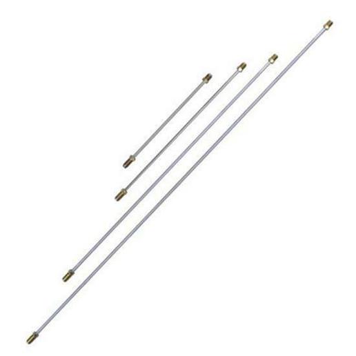

Get some steel tubing the right size (3/8 brake line possibly), some new sleeves for the fittings and make some new lines.

NAPA SHOULD have the 3/8 inch steel line, similar to brake line. It will need cut and bent to the size you need, re-using the line nuts and rubber compression sleeves on each end.

You might have misunderstood what we are talking about. I'm not surprised TSC didn't have auto brake lines, but most auto parts stores generally have a selection of them in various sizes and lengths; standard and metric. NAPA won't have pre-bent fuel lines for your machine, if you want them pre-bent those would be Case parts. The NAPA site on line lists 3/8" steel brake lines, so any store can get it for you. Here are a couple part numbers for plain steel brake lines from the on line site: BK8131242 is 3/8" x 30" long, BK8131245 is 3/8" x 60" long. These are pre-made lines with inverted flare fittings on them. Use a tubing cutter (get a cutter if you don't have one, don't use a hacksaw) to cut the inverted flares off the line and then slide the inverted flare nuts off the tube. To do a neater job, get a tubing bender for 3/8 tubing when you get the lines. Using that bender and your tubing cutter duplicate the old lines. As Dieseltech said reuse the old fittings and nuts, you should only need new sleeves to go in the old fittings.

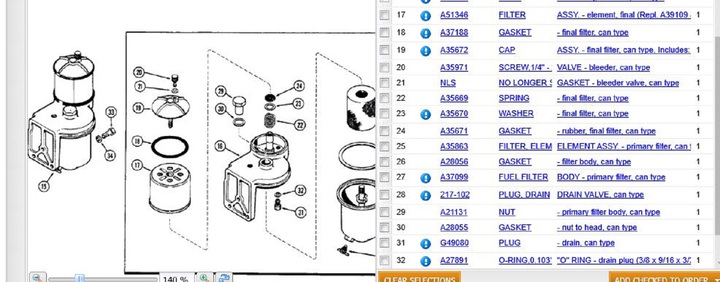

I did misunderstand you...I did get the right tube cut and bend the brake line, Im not sure but still can't locate the size of the secondary fuel filter bleeder that is built into the filter housing unit. I haven't found a case dealer website, perhaps someone can provide their site / phone number to avoid future case parts. This case is a 580 Construction King powered by 188 diesel. thanks Jerry

PostPosted: Fri Jan 17, 2020 3:04 pm    Post subject: Re: 188D FUEL lines Reply to specific post Reply with quote
First where are you located, general area? People maybe able to give you better ideas on finding parts with that info.
Do you know where you nearest Case construction equipment dealer is located or is that what you want to know?
Do you have a parts manual? If not do you know about and use the on line parts books? Having part numbers helps with searches.
Is this picture your fuel filter set up and are you looking for item key number 20? If not post a picture of what you have.
