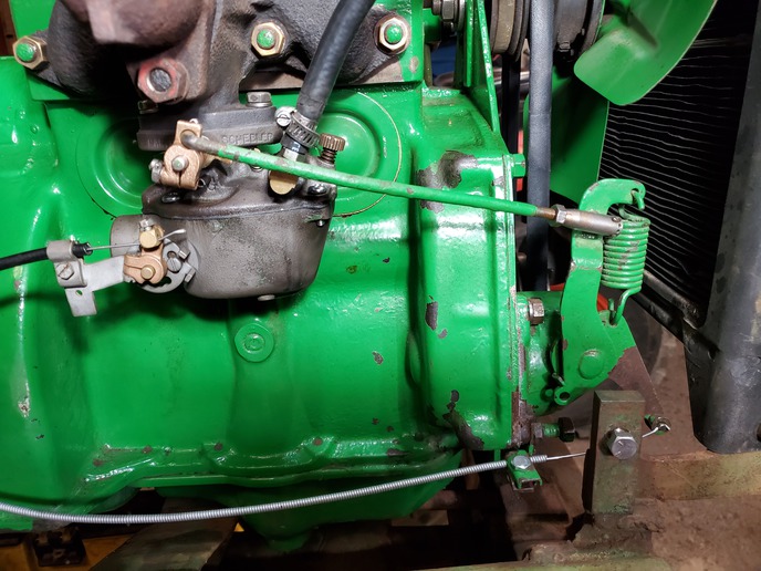

Here's a pic of how i have it setup now. It runs real good when operating the throttle by hand

I don't think my la has that flat piece
of flat with the bolt in it in the middle
of the arm and cable holder. I'm thinking
the arm looks like it would hit it an not
let it throttLe up. On the LA u pull back
on the thottle rod for faster engine
rpms. Let us know more an we will get you
going .

That's just a mounting spot for the hood and cowl piece

I just looked at the one in the shed and it is hooked up the same as your. What is yours doing. Runs to fast or will not run up on rpms.

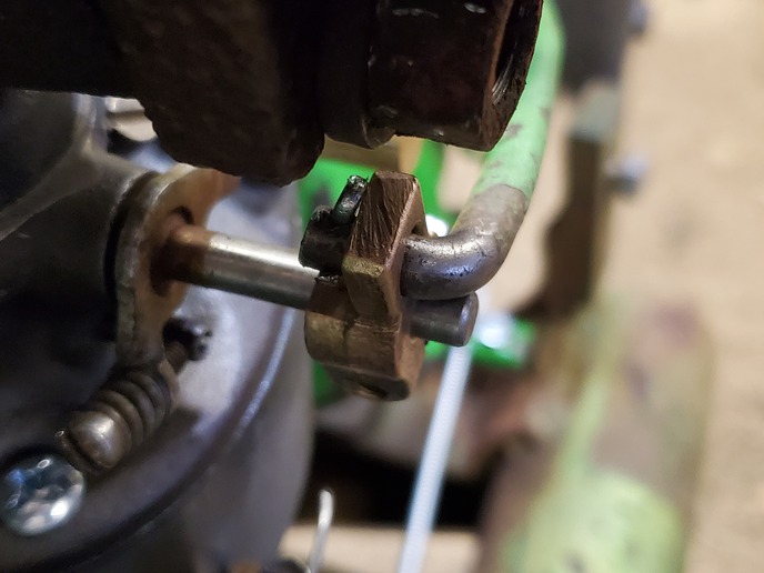

I would check and see that them two arms on the governor move by them selves. With the motor off pull the throttle rod back and see if the one to the carb is free and move back and forth. If not them to are stuck together and need to be free. The one arm with the cable to it pull against that spring and the other runs with the governor to make it run at a set rpm. If them to are loose then when the motor running and you push the carb open some there should be pressure on the arm pushing it back to idle. If there is to much play in that rod to the carb from the governor the motor will run fast so you need to adjust that rod so there good pressure pushing the rod to the carb back when running . What I like to do on them is I have the linkage loose on there with the cotter pin out and adjust the rod to put pressure from the governor to the carb with the motor running at idle. Let us know what you find out.

I had a bind in the brass piece on the throttle rod cuz it was on backwards. I did it not knowing how it was supposed to go. Live and learn. The governor is back in office now working again
