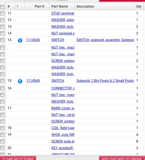

According to 450 gas diagram I have, the 450 used a resistor start bypass system. Voltage from I post on starter supplied 12 volts to input of coil to bypass resistor for hotter starting spark
The solenoid shown is only 3 post. It would have the S post to engage solenoid but no I output post to bypass the resistor.
There are similar 4 post versions available

The bypass to the Coil past the Resistor is not necessary for the tractor to start effectively. If it is, then please don't tell the thousands of tractors that have been converted to 12V from 6V and a resistor added to the only positive wire going to the coil. They start just fine and do not need the bypass.
Yes, you can get the other Solenoid that has the 4th post, TSC has them on the shelf, the last time I was in there.

I know a lot of parts books refer to them as relays but then a lot of them just call them a switch
like the online IH parts books often do .
Now as far as the amount of terminals, WELL, the first year the 450 was made it was a 6 volt
system on gasoline tractors so one single small terminal on starter relay. Then when they
switched to 12 volts they used the two small terminals with the one being the bypass for starting.
Most engines start better with the bypass system. I myself have two tractors converted to 12 volt
with no bypass and they do start fine but if I had a true 12 volt 450 I would use the bypass
system. Just the way I am.
