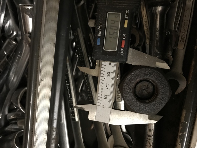

I am wondering how the front wheels can have such a big lug nut using a 1 3/4 socket you figure, when the rear wheels use 1 1/8 socket.

I went work on the lug nuts today (12 degrees in the barn) and I can report there are 10 - 1 1/2? lug nuts on the front axel of an IH 706 with front wheel power assist.

I had a most fortuitous situation yesterday. After leaving Harbor Freight empty handed yesterday, I stoped to see my parents. I was telling my father about my new project and my need for large sockets. Out of the clear blue he said check in the back porch your grandfather?s mechanics tools are in the back corner under a bunch of boxes. Upon digging the old toolboxes out I found a complete set of S and K sockets going up to 2 inches, a total game changer.

My grandfathers old sockets that I found yesterday in my parents back porch, a little heat and some penetrating oil and the wheel popped right off. Next step installing a tube, so I can get this thing out of the barn.

You've got an Elwood axle on your 706, not the usual Coleman that would have come from the factory at that time. Coleman has 12 lugs per wheel and from what little I could find in the online parts book, only 1/2" diameter fasteners.
Elwood's a marginally better axle, better turning radius at least.

I was more interested in seeing the front wheel picture with those nuts. thanks for posting.
