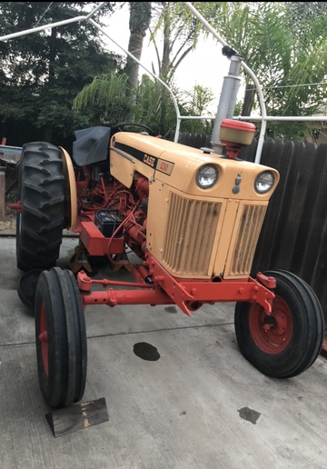

Hello, I am having some throttle problems on my late 1960?s case 530. I think I am maybe missing a ?return spring? (#43 on parts diagram)? Does anybody have a picture of their case 530 throttle setup? Mine works fine if I pull throttle rod (#50) the engine will rev but Using lever (#1) or pedal (#27) the engine does not rev up so I am trying to find the problem. Thank you.

Here s a pic of my throttle spring. Whether all is working properly I don t know. Haven t had much time to work on her since purchased.
